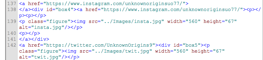

HI there I have just completed an ebook which is fine. . . until I put in about 6 url links on a few social media images at the back. sure its resolved simply though.
The error is on line 138 where the says: Error while parsing file: element "div" not allowed here; expected element (screen shot attached)
also attached is screen for line 138 in sigil. what do I change. the same error is repeated so once I solve this I can correct the rest. what do I delete or replace??

You can't nest div or p tags inside of a tags to my knowledge.

You want your <div>s and <p>s on the outside + your <img>s and <a>s on the inside:
<div class="social"><img alt="" src="../Images/instagram.jpg"/></div>
<p><a href="https://www.instagram.com/example">https://www.instagram.com/example</a></p>
<div class="social"><img alt="" src="../Images/twitter.jpg"/></div>
<p><a href="https://www.twitter.com/example">@example</a></p>

thanks for that and I do understand what you are saying and I've tried it but obviously missing something my end.
can you let me know exactly how this should read and I can repair the others? this is how each one is laid out as follows:
<a href="https://twitter.com/UnknownOrigins9"><div id="box5"><p class="figure"><img src="../Images/twit.jpg" width="560" height="67" alt="twit.jpg"/></p>
</div></a>
IS THIS BELOW CORRECT because I lose the URL and doesn't work:
<div class="figure"><img src="../Images/twit.jpg" width="560" height="67" alt="twit.jpg"/></div>
<p><a href="https://twitter.com/UnknownOrigins9"><div id="box5"</a></p>
ebookscovers is offline   Reply With Quote

If you're trying to make the image an actual link, then that's fairly hit-or-miss when it comes to working properly across a range of devices/apps. That's probably why you "lose the URL and doesn't work". Especially if you're testing on something that uses Adobe's RMSDK for rendering.
Many devices provide some sort of pan and zoom functionality with images that wouldn't work if tapping on an image were to follow a link instead.
You're better off using text for the link and adding the image separately.

You lose the link because there's nothing between the opening 'a' tag and the closing 'a' tag to BE the link. There also still seems to be some syntax errors in general with that snippet.
Sigil doesn't appear to be related to the issue here. You seem to need to do a little brushing up on html in general.

You can't do the part in red:
</div></a>
You have to stick <div> on the outside, then <p>, then <a>:
<div id="box5">
  <p class="figure"><a href="https://twitter.com/UnknownOrigins9"><img src="../Images/twit.jpg" width="560" height="67" alt=""/></a></p>
</div>

No. Your <p> is still wrong.
You see the broken <div>? Plus the <div> cannot go inside of a <p>.
