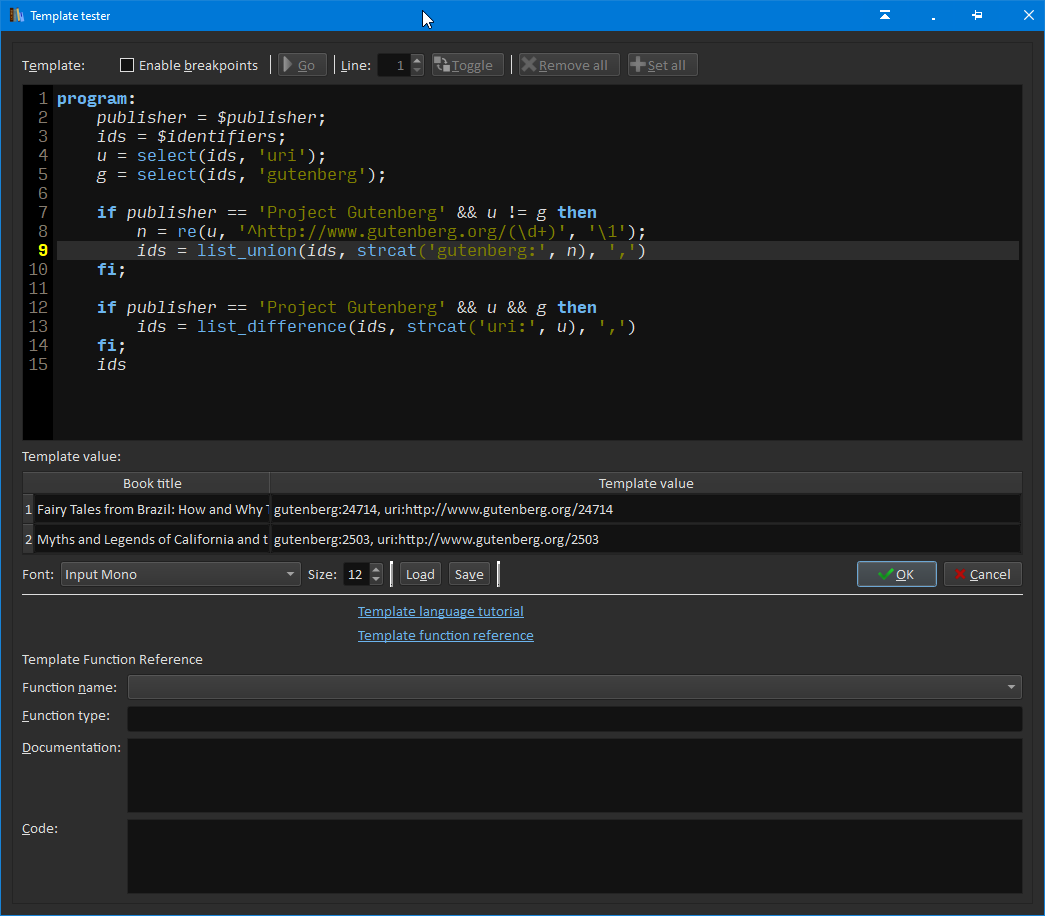

Any ideas why the second part of this template isn't removing the URIs?
Name:	2021-05-01 17_27_30-Template tester.png
program:
	publisher = $publisher;
	ids = $identifiers;
	u = select(ids, 'uri');
	g = select(ids, 'gutenberg');
	if publisher == 'Project Gutenberg' && u != g then
		n = re(u, '^http://www.gutenberg.org/(\d+)', '\1');
		ids = list_union(ids, strcat('gutenberg:', n), ',')
	fi;
	if publisher == 'Project Gutenberg' && u && g then
		ids = list_difference(ids, strcat('uri:', u), ',')
	fi;
	ids
Attachment 186872
program:
	ids = $identifiers;
	fi;
	fi;
	ids
Are you certain that the conditions in the second 'if' are all True, that both 'ids' are set when the template starts? Run it using breakpoints to check (and record) the values.
Also, both conditions check for "publisher == 'Project Gutenberg'". You could test that once and put the other tests as nested ifs.

Actually I think it's a mistake of what I thought template tester was doing; I was testing with books that only had uri. If I add gutenberg: and test again it removes the uri: identifier.

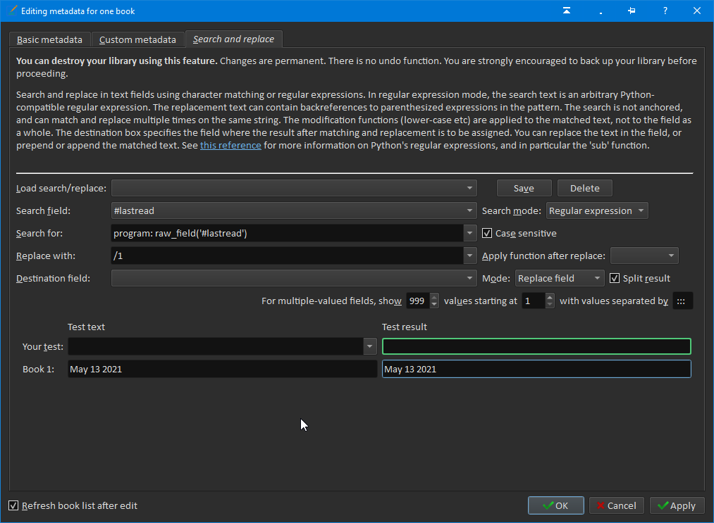

This resets the time to 12:00:00. Did I make a mistake?
That S&R doesn't do anything. Templates are not evaluated as search expressions; they are interpreted as plain text. A template is evaluated only if you use "Template" as the source field, and then only if you put it in the "Template" box.
The replacement of /1 is also plain text. I suspect you wanted \1.
What are you trying to do?

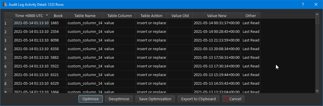

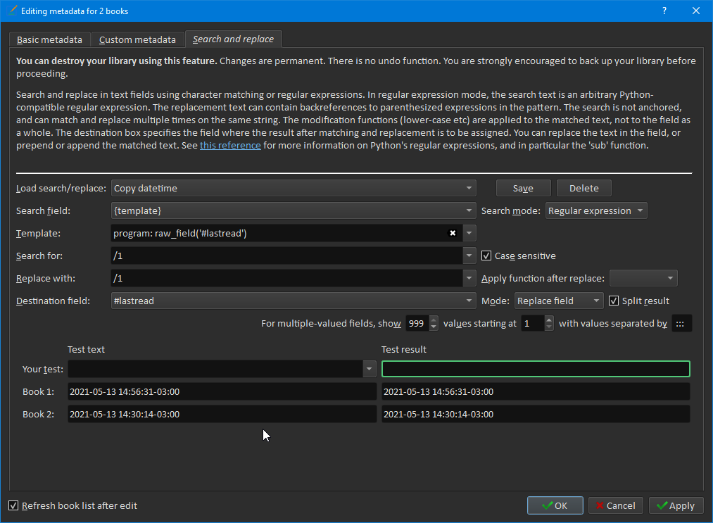

I accidentally wiped out my Audit Log while troubleshooting plugins so I was copying the column to itself so that AL had a record of the original values. I figured out what I had to do though.

I accidentally wiped out my Audit Log so I was copying the values to themselves so that AL had a record of them. I figured out what I had to do though.
It works by accident.
Searching for /1 finds nothing because that character sequence doesn't exist in an ISO date. Replacing with /1 would replace with exactly that text, /1, but since nothing was found, nothing was replaced.
You probably wanted search for ^(.*)$ and replace with \1. This matches the entire source and replaces it with itself
