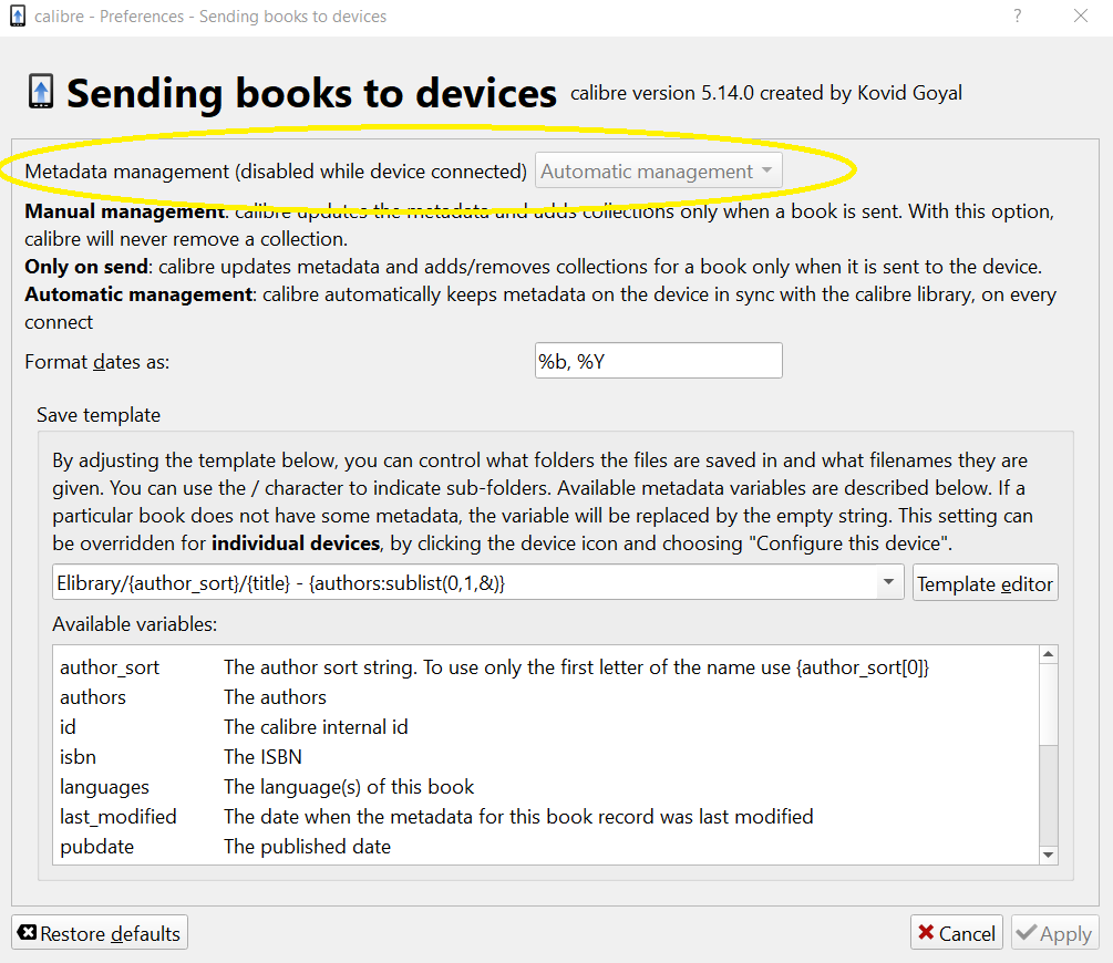

Alternately and my preferred solution is if you set metadata management to automatic (Preferences => Sending books to device => set Metadata management to Automatic Management), the next connect should automagically update the metadata.
Thank you for your replies!
I didn't know, that the two steps are necessary.
I've tried to update cached metadata on the device as DNSB described - it works!
I've tried to set metadata management AUTOMATIC - it works! (Both of course after disconnecting and connecting the device again)

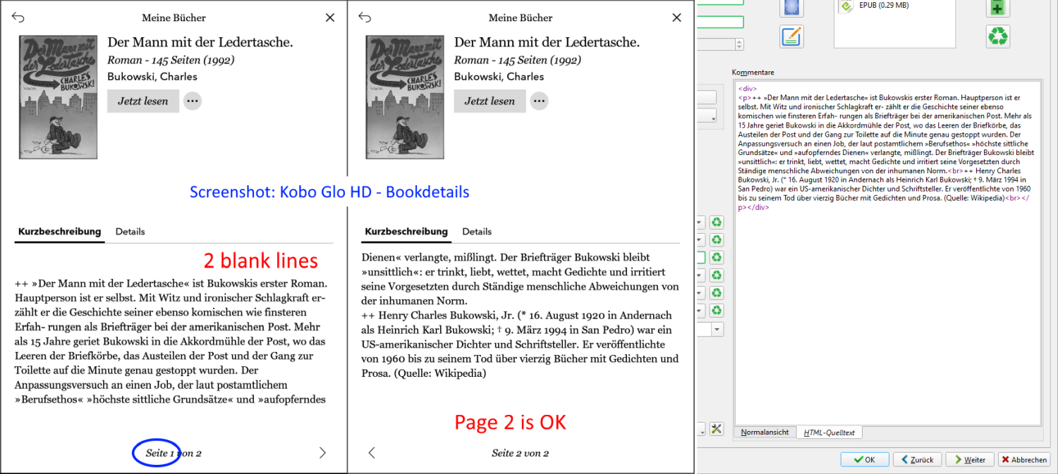

I've got another question: I add comments-metadata to all of my books, on the device visible under "bookdetails" (I think Kobo calls it Synopsis).
On my Kobo Glo HD the first page of the comments always starts with two blank lines. In Calibre -> Metadata -> Comments the HTML-Code doesn't include any margin-commands (see screenshot). Books I transferred to the Kobo 2018 or earlier don't have these blank lines, maybe they came with a software-update (Calibre, KoboTouchExtended-Driver or Kobo-Firmware...?) How can I get rid of these two blank lines?
I am not seeing that. Are you using a metadata plugboard to set the comments/synopsis? If so, what does it look like? If it has any line feeds in it, they can show on the device.

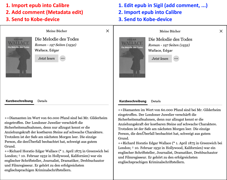

So I did an experiment:
1. I took 2 epubs from different sources, imported them into Calibre, did some rework (cover, css-style, ...) and inserted the comments (Edit Metadata -> Comments). Then I transferred them to the Kobo-device: result as expected - in the book-details the comments start with two blank lines. I deleted the ebooks from Calibre and the Kobo.
2. I opened the epubs in SIGIL (vers. 1.4.3), did the same rework there, added the comments and THEN I imported them into Calibre.
After sending them to the Kobo, everything looks fine, there are no blank lines above the comments!
I have no idea, how that comes...

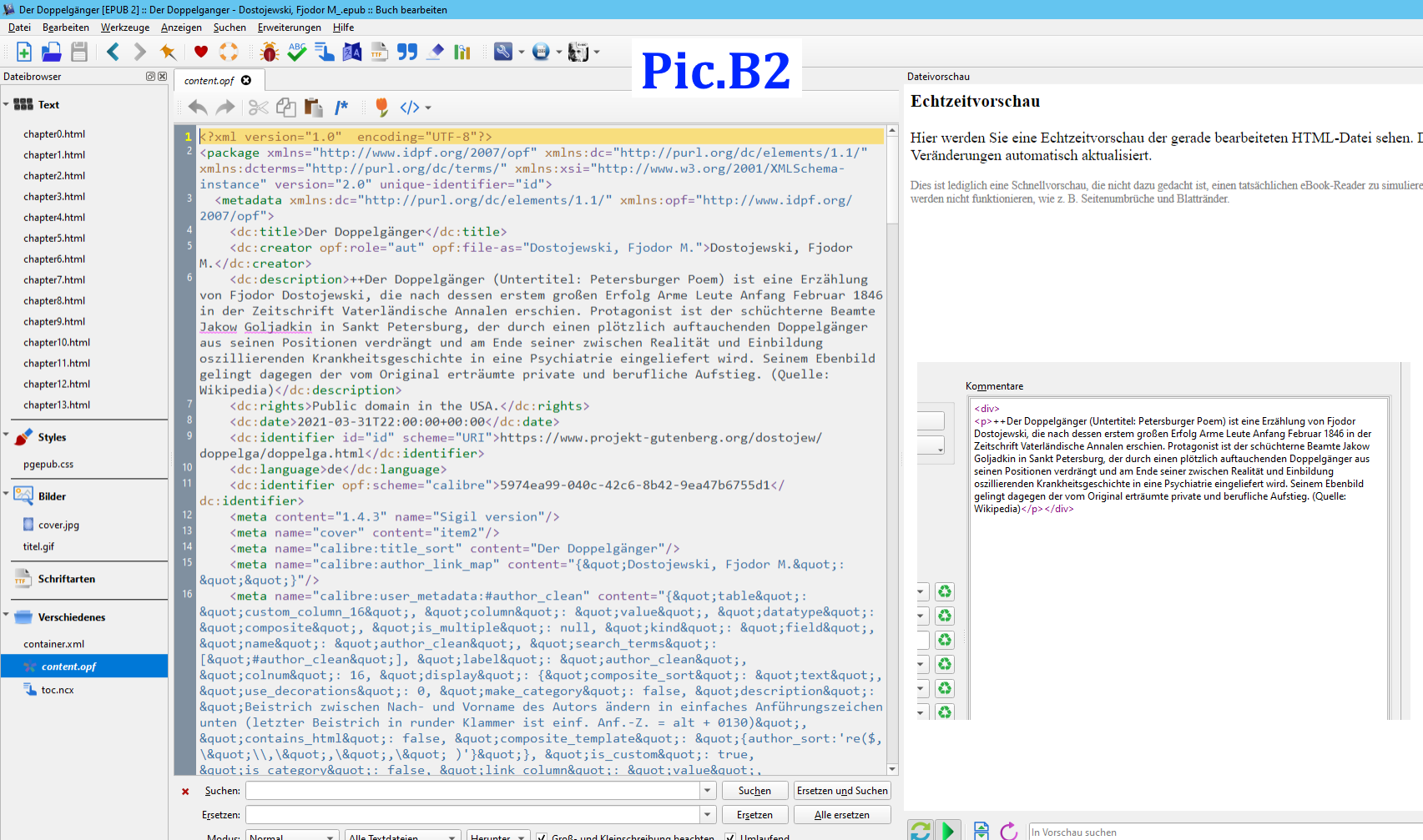

In Calibre post what is in the description for both version showing the HTML code for both. Then we can see what's going on and how to fix it.

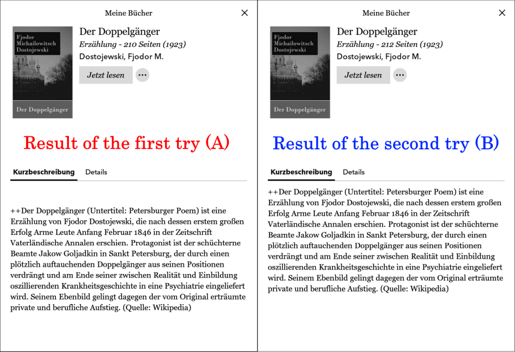

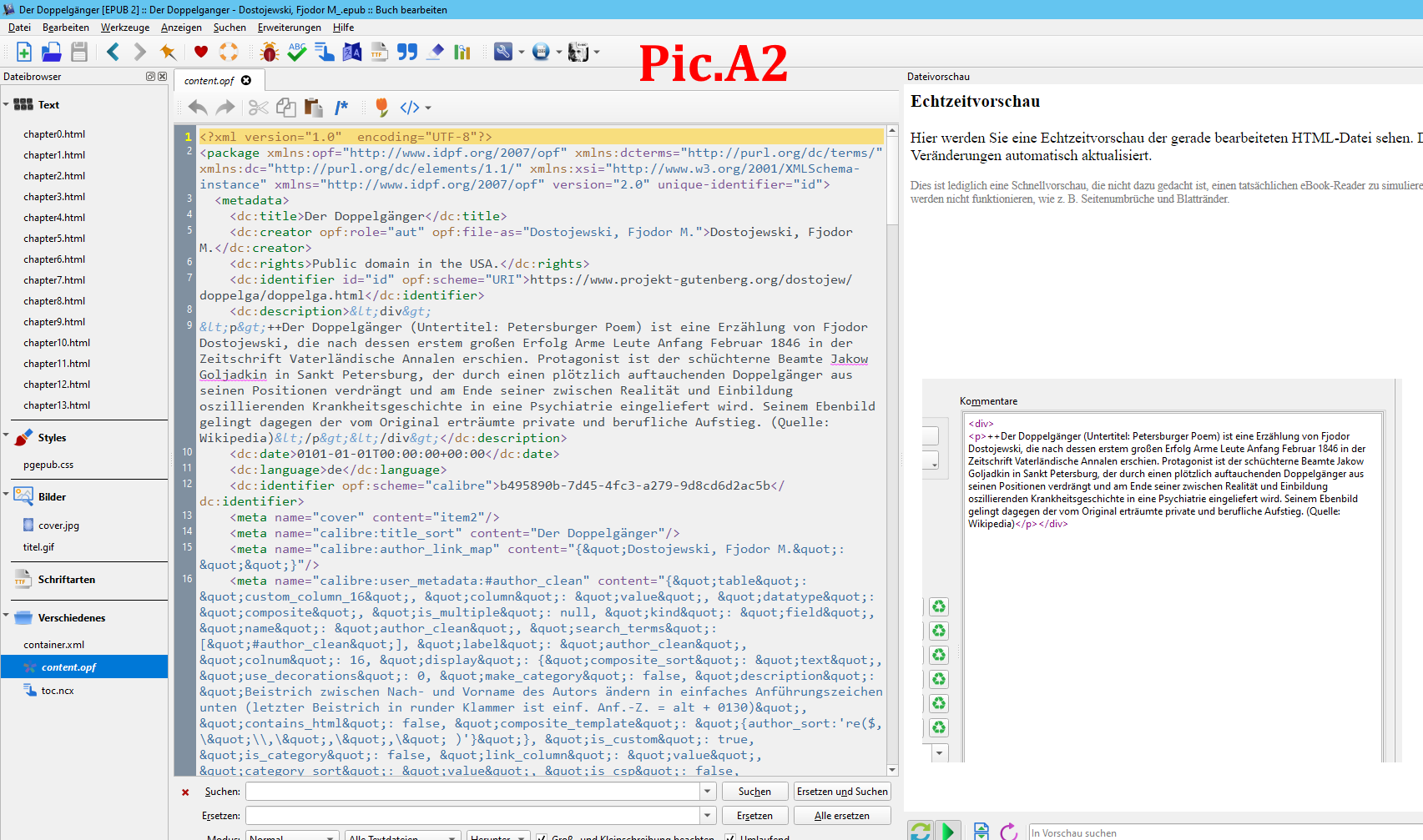

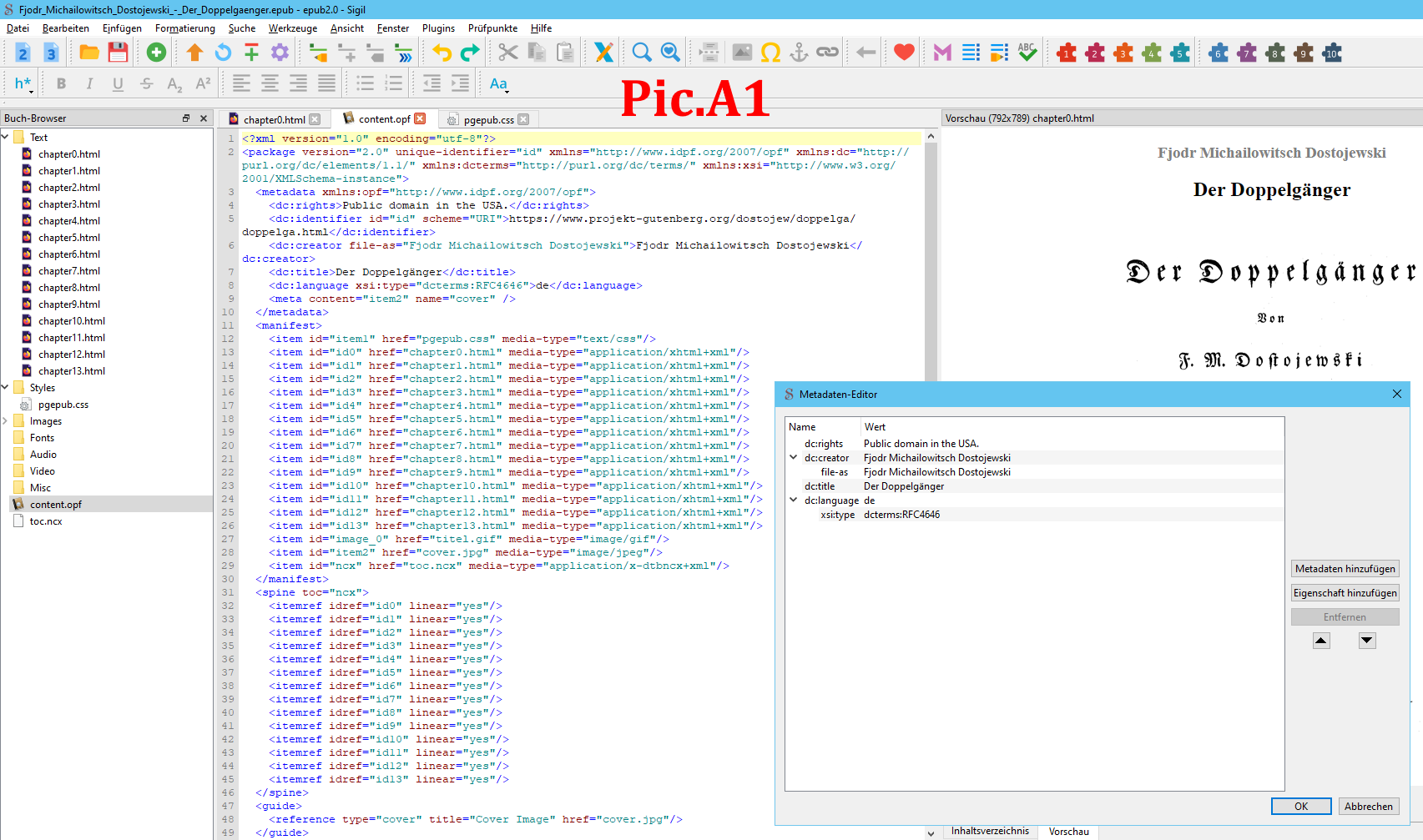

Pictures say more than a thousand words, so here is an illustrated version of the above mentioned steps I did:
First try (A): Import of the original epub into Calibre, adding a cover and the comment-text by copy (from the text-source eg. Wikipedia) and paste. Then send it to the Kobo Glo HD (using the KoboExtendedTouch-Driver):
Pic.A1 shows the orininal epub (content.opf and Metadata-Editor) in Sigil, no work done on it yet.
Pic.A2 shows that epub imported in Calibre (content.opf and HTML-Code of the comment). The comment was added in Calibre by copy and paste, text-formatting was removed.
Pic.Result (A) shows the (not wanted) result on the Kobo.
Second try (B): Open the original epub in Sigil, add the comment by copy (from the text-source) and paste in the Metadata-Editor - "dc:description". Then import the epub into Calibre, add the cover and send to the Kobo.
Pic.B1 shows the epub reworked in Sigil.
Pic.B2 shows that epub imported in Calibre. There is a difference between Pic.A2 and Pic.B2 in the content.opf, even if the HTML-code in the comment-fields looks the same.
Pic.Result (B) shows the desired result on the Kobo.

The issue is on the device. The synopsis doesn't handle carriage returns in the way that most HTML parsers do. They are usually ignored or replaced with a space. And anything between tags will be ignored. And because of the way that the control used when editing the comments in calibre formats the comment, there are carriage returns after the leading div tag. Which the control probably added. I assume the metadata editor in Sigil doesn't put any extra carriage returns or tags in. This overall problem was discussed a while ago, but, I didn't notice it affected the start of the synopsis.
Until Kobo changes this (and I recommend you report it) the workaround is to use a metadata plugboard for the comments. Simply use the template "{comment}". When this plugboard is processed, any extra whitespace is removed.
Old 04-02-2021, 09:26 AM   #2501
troro
troro doesn't feed trollstroro doesn't feed trollstroro doesn't feed trollstroro doesn't feed trollstroro doesn't feed trollstroro doesn't feed trollstroro doesn't feed trollstroro doesn't feed trollstroro doesn't feed trollstroro doesn't feed trollstroro doesn't feed trolls
Posts: 7
Karma: 81728
Join Date: Nov 2017
Location: Austria
Device: Kobo Glo HD
I don't have the skills to exactly understand the technical details you're talking about, but I'm happy to say, that you are right!
I've been thinking about that problem for quite a long time, checked my settings over and over again...
Waking up today, reading your posting and only a few seconds later about 3000 ebooks on my Kobo-device are corrected!
THAT'S JUST MAGIC!!!
Thanks to David and many others out there who provide us with fantastic software and tipps. We appreciate your work very much!
Have a nice day!
