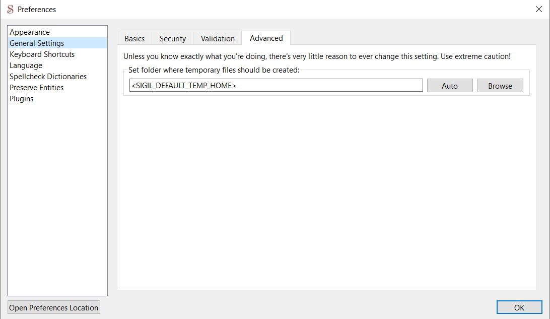

Has anyone who can produce the problems on Windows tried giving Sigil a dedicated Temp location via the Preferences setting? There are 3rd party gadgets that 'clean up' the Windows temp location given an opportunity.

I have made some shots of my settings. As far as I can tell I am using the default temp location.
