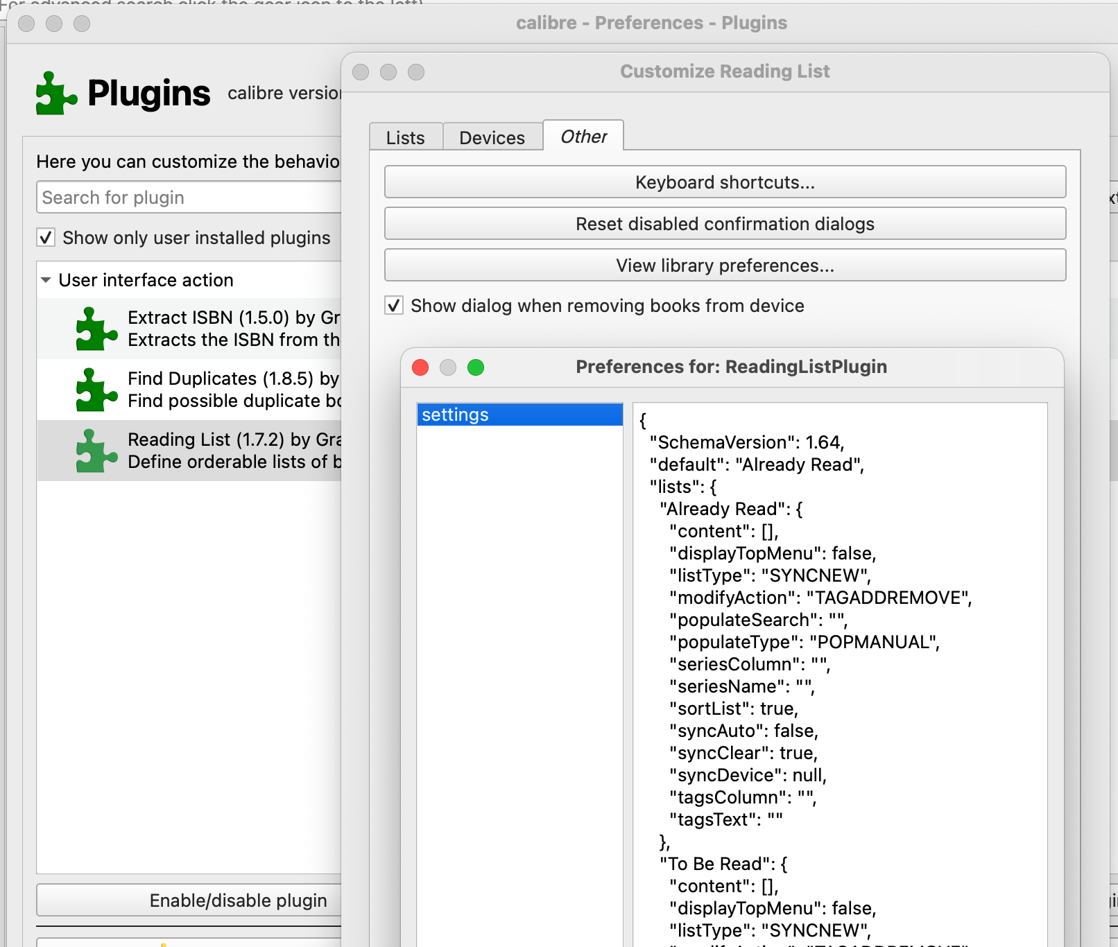

[Solved] Unable to Reset Reading List Plugin
I edited the plist file, entering the name of an existing list as the Default name (instead of leaving it empty) and that got everything working again. (See attached screen snap.)
Name:	Screen Shot 2021-04-10 at 1.40.54 PM.png
paul55391 is offline   Reply With Quote

Wait--you can edit the settings there? Really? Well, that's wildly dangerous.
Useful in this particular case, but still hilariously dangerous.
Is that how you got to this state in first place? Editing the settings directly instead of using the buttons? Because there is absolutely no error checking done there.
If not, I'd still like to know how you got there.

JimmXinu, I hope my previous post (#1076) describes ‘how I got there’ (i.e. how I screwed up Reading List).
I don’t know why it is wildly dangerous for me to edit the .plist file. I suppose if I entered some garbage file name, something strange might happen, but I proceeded fearlessly.
Of course, I did use the GUI initially, but after I screwed things up by deleting “Default”, and after then uninstalling Reading List, then reinstalling it, and still not be able to use the GUI to configure Reading List, it was quite reasonable to avoid the GUI and edit the .plist file, IMO.
If you want, I can try to first duplicate the problem, and then I can update Reading List and repeat what I did and confirm I no longer need to “edit the .plist file. I’ll proceed now and will post my results…
