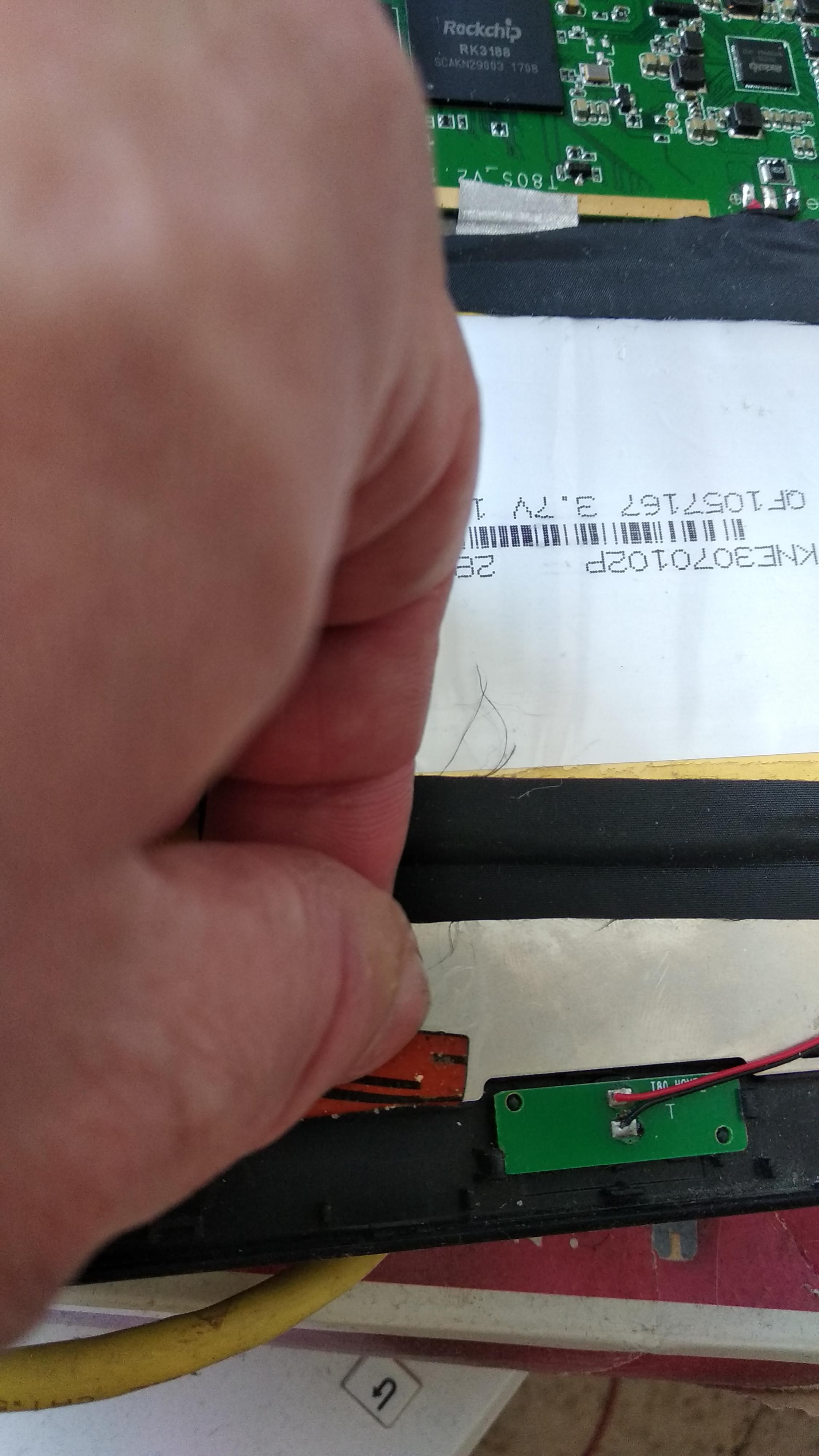

These are interiors of my old Plus. (I cannot charge it anymore due to faulty USB port). I wonder if the gray wire at the left side that got detached from the board may have served as WiFi and Bluetooth antenna.

A WiFi aerial is about 1cm to 4 cm long folded metal or shaped PC tracks fed by a thin coaxial cable (an outer screen and concentric inner wire). That grey wire only for WiFi if it has an inner and outer pair of wires. I can't tell from the photos.
Cleaning would have no effect. If the aerial has come out of place or one wire is damged?

The gray wire seems to be single wire, it has apparently been soldered to motherboard but got detached. It connected motherboard to the thing I am holding with fingers on the left photo, is this the aerial? (What else a single wire can serve for? I thought previously it was detector of opening/closing the cover.)
Update: the grey cable does seem to be coaxial one.

So the small PCB is an aerial and the grey wire is miniature coax cable, like on a TV set or satellite box, but much smaller!
The location of the PCB aerial can be important and they can come loose.

I opened my Muses and figure out that the thing I was pointing with finger at the photo was the aerial. (If you try it, be sure not to lose the power button, it is tiny and falls out. Needless to say, If you try it I am not responsible for any damage you may cause.) The soldering of between it and the connecting wire had been broken. A kindly guy soldered it back for me and now the connectivity is normal. That guy soldered the aerial of my old LB Plus as well, but he was unable to fix its USB port, so I cannot test it.
