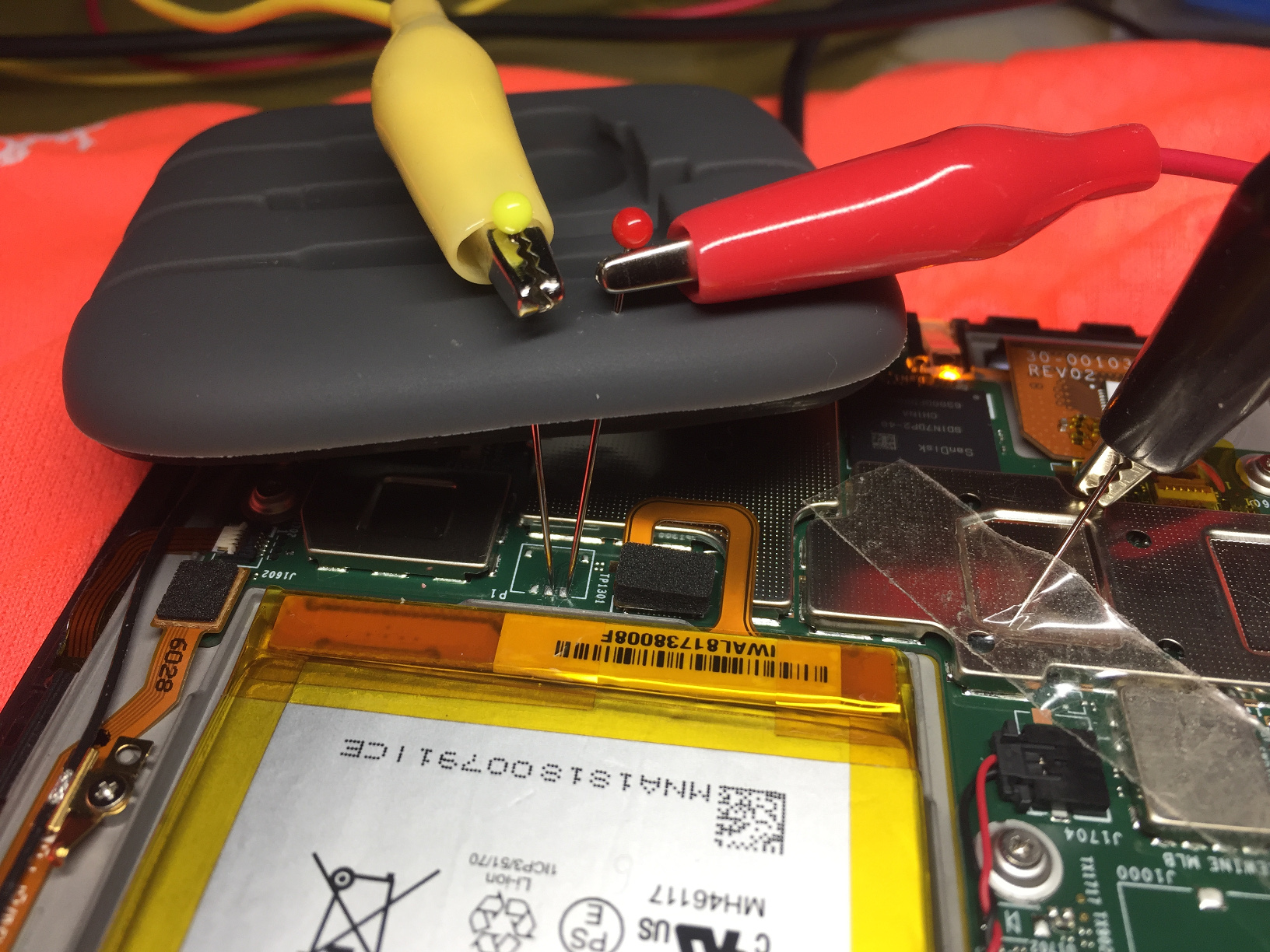

I have successfully jailbroken a new (refurbished) KV shipped with fw 5.10.2.
Some particular notes:
  • I've used this adapter, with jumper placed at 1.8V. I've only needed 3 cables: TX, RX and GND.
  • I've managed to use the no-solder-but-pins solution:
    I've used a rigid rubber earphones case to hold pins in place.
  • I've found special difficulty in closing the KV. This noismaster post has the key points to properly achieve KV closing.
Thanks to every poster in this thread, and in the KV serial jb thread.

Peel back the tape (Yellow Kapton tape). I Glued it temporarily on the battery. Note, careful this tape seems to stick a lot to the flexible printed circuit.
5. Connect the USB converter board!
I did use the idea from Dennish connecting without any soldering (Great idea!).
I did push the pins through the foam in such a way that the points arrived at the top of the solder pads, the other side of the pins were about 1.5 cm away. Then, I pinched the pins to spread open their points and push them on either side of the pads ... The tension induced by the foam on the pins was enough to make a good contact. It was even enough to return the PW3 and read the screen without losing the contact.
Centre pin goes to the TX pin of the adapter. (green wire)
Bottom pin goes to the RX pin of the adapter (red wire)
Ground using a screw… (black wire) …
1.8-volt reference on the adapter itself
Watch out, it may look like the RX and TX contacts are ok as a character is echoed. If the ground is not secure some funny characters pops up and that can freeze the kindle (twice) or the KiTTY terminal (at least once). I ended up replacing the alligator clip on the screw with a wire tightened under the screw.
Note that I did NOT remove the battery nor the connectors to setup all that.

I'm ready to serial jailbreak my PW3, but how do I power it on now?
I have the case open and some sewing pins touching the pads of the motherboard as per the non-soldering method. It's ready to go but I don't know how to turn it on now. I see where the power switch must be, and I see the plastic button on the case, but I don't see how it activates the power.
Is there some trick to it? If not, I'll have to just solder some wires, but I'd rather not as the soldering pads are very small and my hands are not very steady.
2015 Paperwhite 3.
Thanks!

Never mind. I pushed on the small yellow spot and it clicked and powered on. I have to just secure the RX and TX connections and hopefully I'll be good to go.
