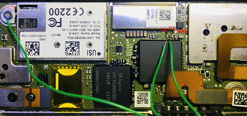

Hi! After some experiments, I finally find out the serial port of Kindle Oasis 1 (Tx, Rx, and GND) as in the picture.
[IMG=853,400]https://www.mobileread.com/forums/attachment.php?attachmentid=181269&stc=1&d=1597236 967[/IMG]

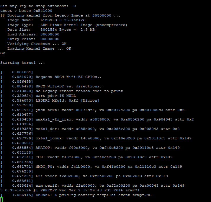

I successfully access to uboot by connect with USB to TTL adapter.
But when I enter the code
bootm 0xE41000
to access diag mode, it stucks somewhere in loading kernel.
Could anyone have any idea?

Here is the serial connection

Congratulations! You are the FIRST to locate the serial port on an Oasis model!
