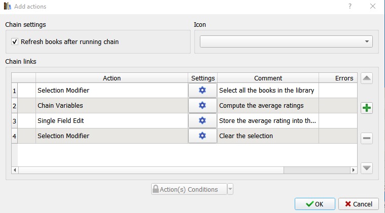

This example action computes the average rating for 3 Genres and their children then stores those ratings in a tags-like custom column in the form 'genre name':average_rating.
Here is the complete chain:

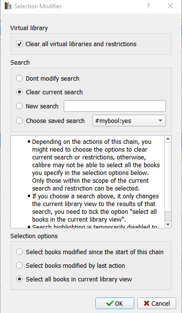

It starts by selecting all the books in the library:

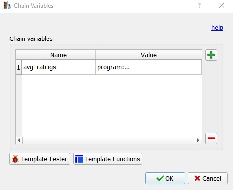

It then runs a template to compute the average ratings, saving that value in a chain variable (global):
The template in the chain variables action is:
program:

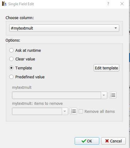

Next it saves the computed value to a tags-like column:
The template in the Single Field Edit is
program:
	globals(avg_ratings = '');
An example of the output is:
Comics:1.5, Mysteries:2.0, Science Fiction:3.0

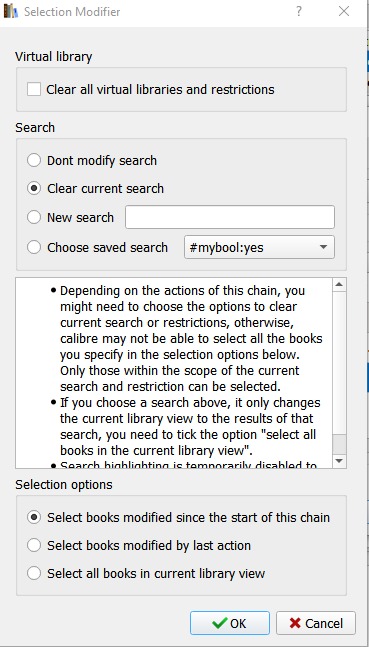

Finally it clears the selection:
