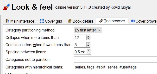

AFAIK, the answer is no. The tag browser is the only place to see hierarchies.
Series (and others) also as main.sub

The dotted representation of a hierarchical column can be shown in the Book List as A.B.C
The elements of such a column can be extracted in a template via the subitems function and loaded into a composite custom column. See Using functions in templates - Single Function Mode
