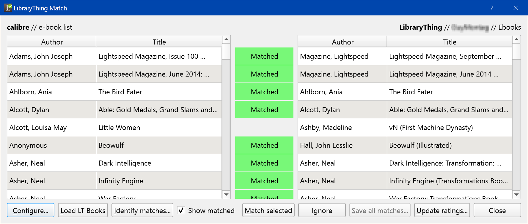

LibraryThing Match plugin - beta testers wanted
Note: This thread will soon be closed to further comments. Please refer to the main thread at :
[GUI Plugin] LibraryThing Match
Are you a calibre user who also uses LibraryThing? Or a LibraryThing user who also uses calibre? If so, I've got a little job for you...
LibraryThing is a social cataloging web application for storing and sharing book catalogs and various types of book metadata. It is used by authors, individuals, libraries, and publishers.
LibraryThing Match (LTMatch) is a calibre plug-in for comparing your calibre e-book list with your LibraryThing catalog.
If you'd like to test LTMatch, please install it manually by downloading the attached zip file, and installing as described in "How do I install a plugin manually?" in the Introduction to plugins thread.
LTMatch can be run in "non-invasive" mode, i.e. without modifying the calibre database in any way. For best results, it can be used with a custom column as described in the attached user guide.
Of particular interest during testing is the "first run" experience, performance with large libraries, and behaviour on non-windows systems.
Thanks and good luck!
ID:	185442   Click image for larger version
Name:	Custom Column.png

Having a quick look at the first post, is there any reason you are not using an identifier and a metadata source plugin? This would tie into the metadata download process and set the identifier for the book. You then have the LibraryThing listed in the details pane and can click to view the page.
You would need a separate plugin to update LibraryThing with your books, or to mark somehow in Calibre that you have the book in LibraryThing. This could be a separate column or a tag.
You probably have considered the above, but I felt the need to put them out there. The comments come from maintaining the Goodreads metadata source plugin and the Goodreads Sync plugin. The latter is doing the steps of syncing between the GR and the calibre library. It does things in both directions. Whether the API you are using allows this sort of interaction, I do not know.

Hi David,
Thanks for your question. The two possible answers are:
1. I was more interested in the simple existence of the book in each source, not so much in syncing the metadata. More a personal preference in how I use LT and calibre.
2. Complexity. This is my first "real" plugin, my first attempt at python programming, and my first experience with web-related development. I wanted to keep it simple.
I have looked at a couple of your metadata source plugins, and I can foresee it wouldn't be TOO difficult to adapt one for LT. I do like the idea of clicking on the identifier to go to the book in LT. I will give this some thought if the current plugin gets any traction.
To touch on your other comments, I do use a "LibraryThing ID" column in calibre to keep track of the matched books. The LT API is one-way, so no facility to update books there.
Bradles is offline

Yep, got your gist now.
LT has concepts of "work", which is the generic published work (e.g. Little Women by Louisa May Alcott) and "book", which is the specific instance of the work as it appears in users' catalogs (e.g. Little Women by Louisa May Alcott, ebook, isbn, cover, my review, my rating, etc.)
I'm using the "JSON Books API" to return the list of users books. LT users are very protective of their book metadata, and I suspect any metadata updates should only come from their book metadata. Unfortunately, this API has no way to return a single book based on any identifier.
The "JSON Works API" returns a work based on an ISBN search, but can only be used once per second and up to 1000 times per day. This would be okay for editing metadata one at a time but not in bulk.
For the ID linking, my quick test worked great:
https://www.librarything.com/work/book/{id}
Simple as that. Would there be any concerns over updating that identifier outside of a metadata plugin? e.g. (cribbing from your Smashwords plugin):
mi = Metadata(...)
mi.set_identifier('librarything', librarything_id)
self.lt_id = librarything_id
Bradles is offline
