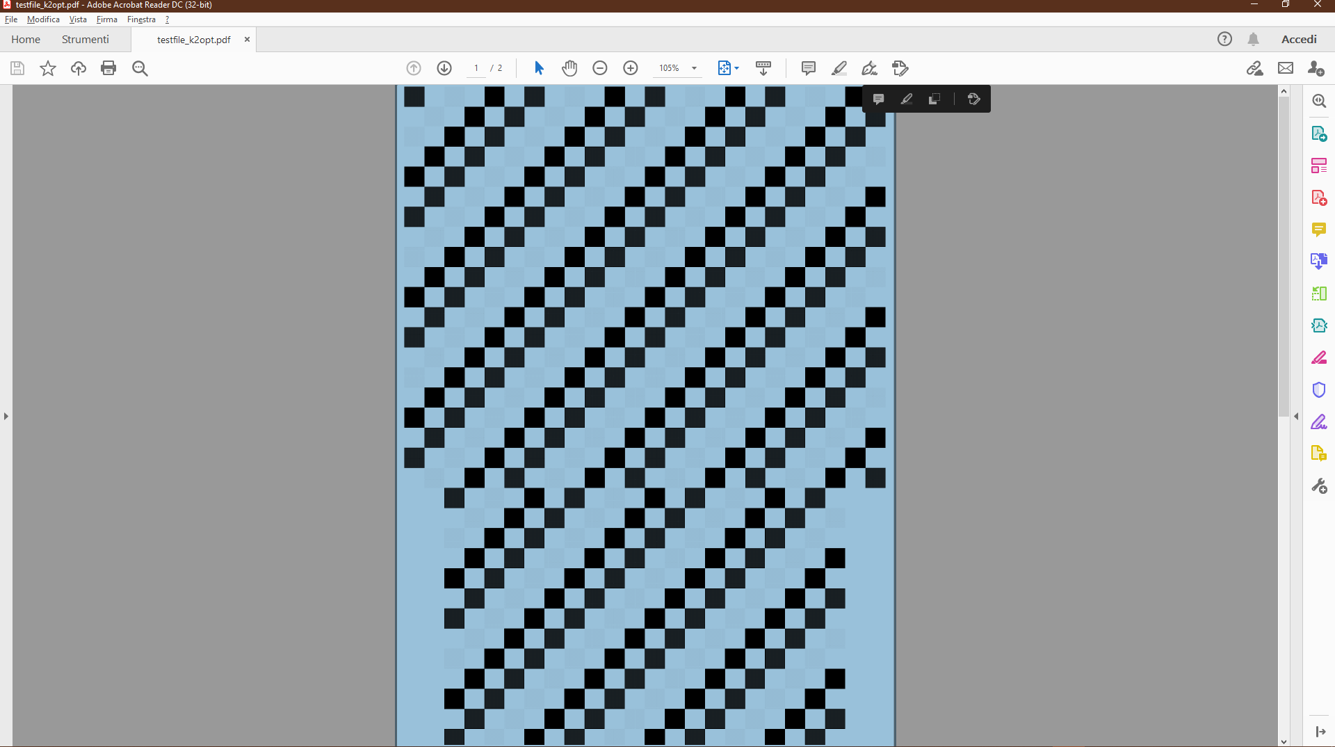

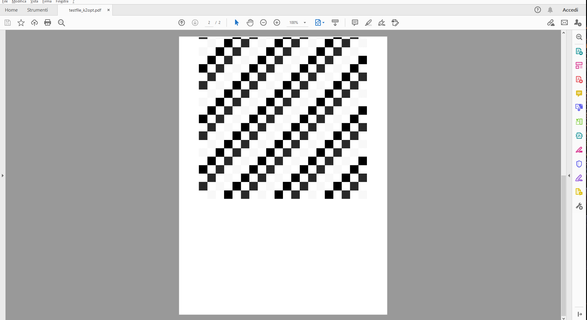

Thanks for your quick reply. In attachment the screenshots of your file test
ID:	185458   Click image for larger version
I meant screenshots directly from the ONYX BOOX Note2--not from Adobe Acrobat. Most e-readers have the ability to capture their screen to a bitmap file with some kind of key press or button press.

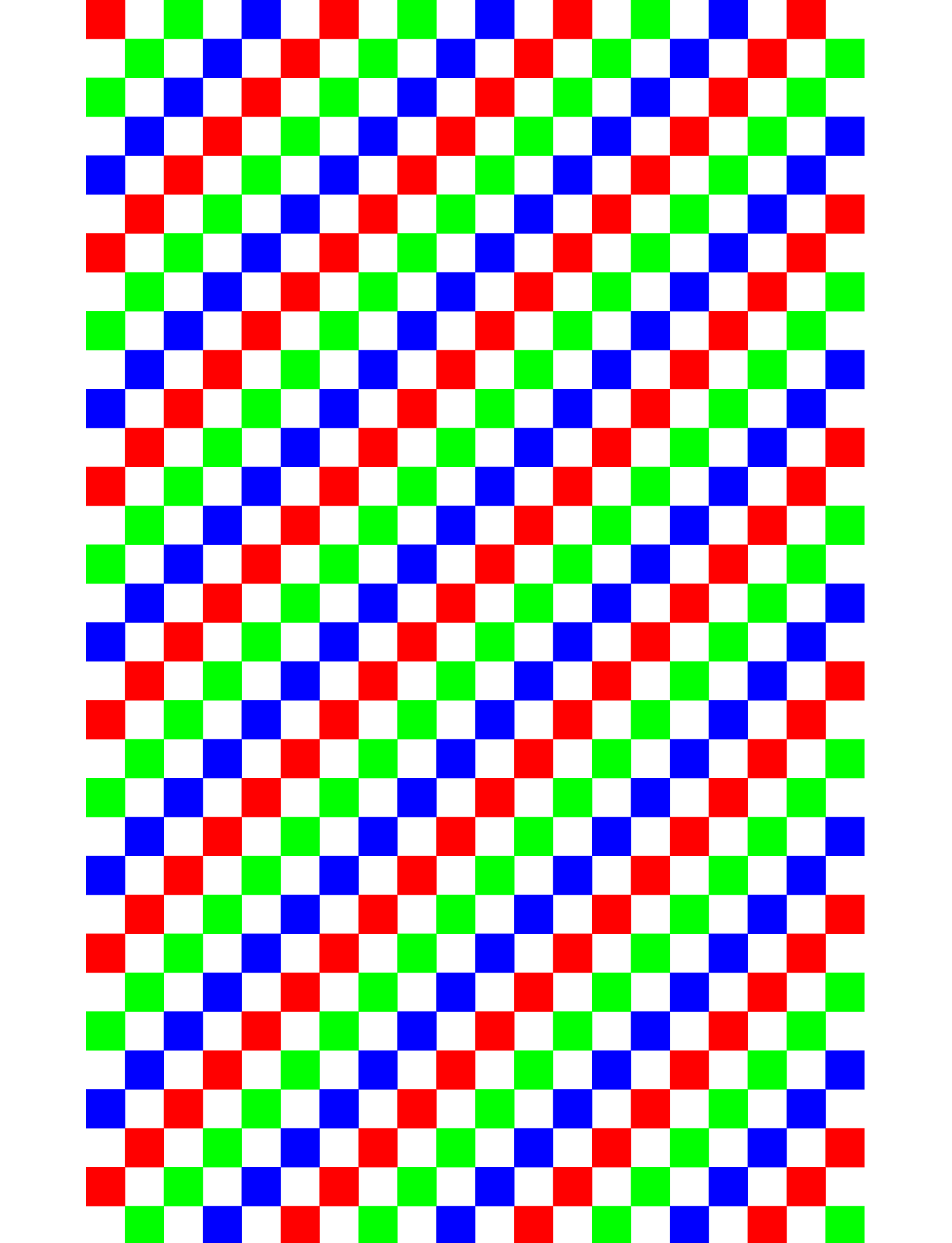

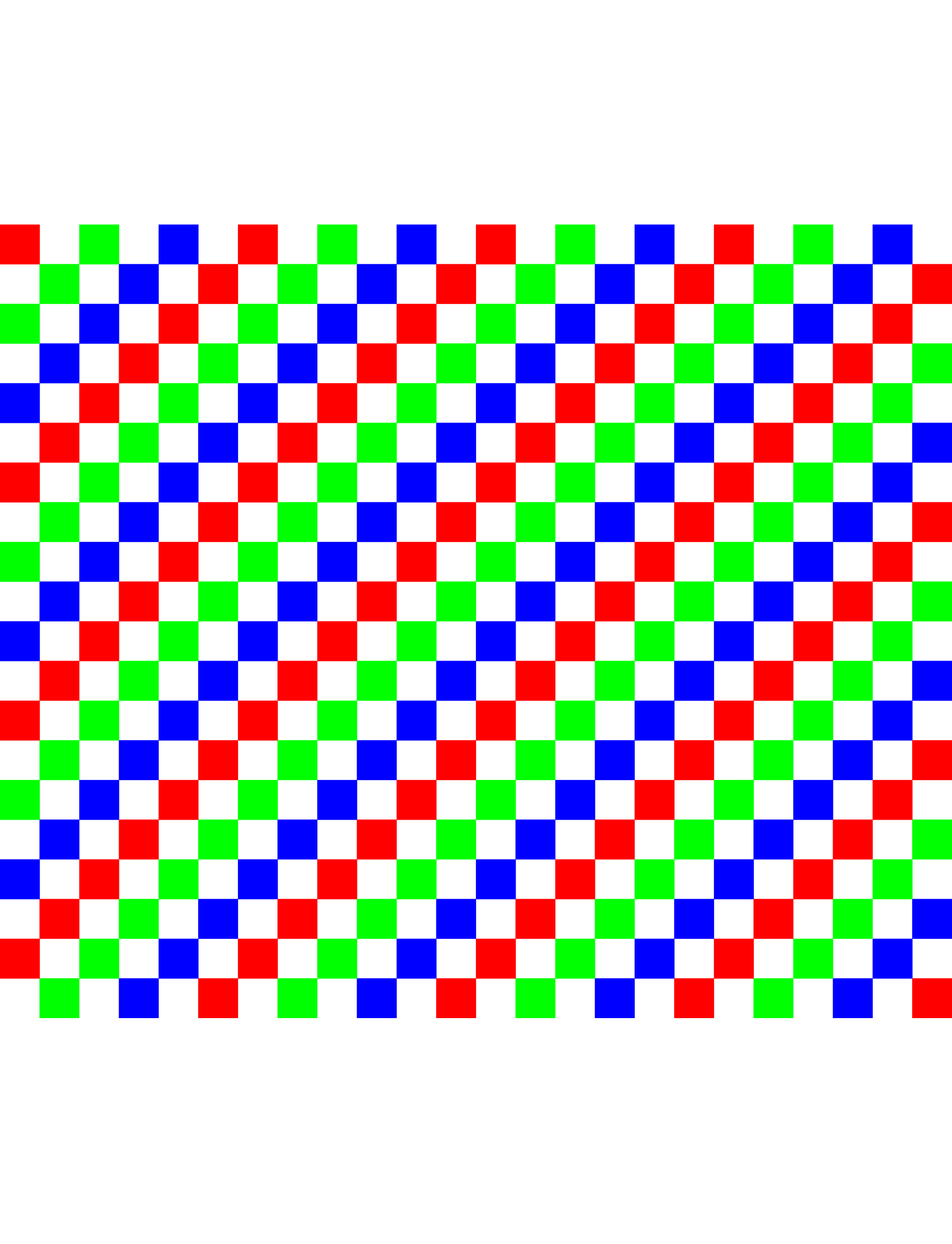

ID:	185473   Click image for larger version

The images are 1404 pixels wide and 1834 pixels high, so the right options would be:
-w 1404 -h 1834 -odpi 227

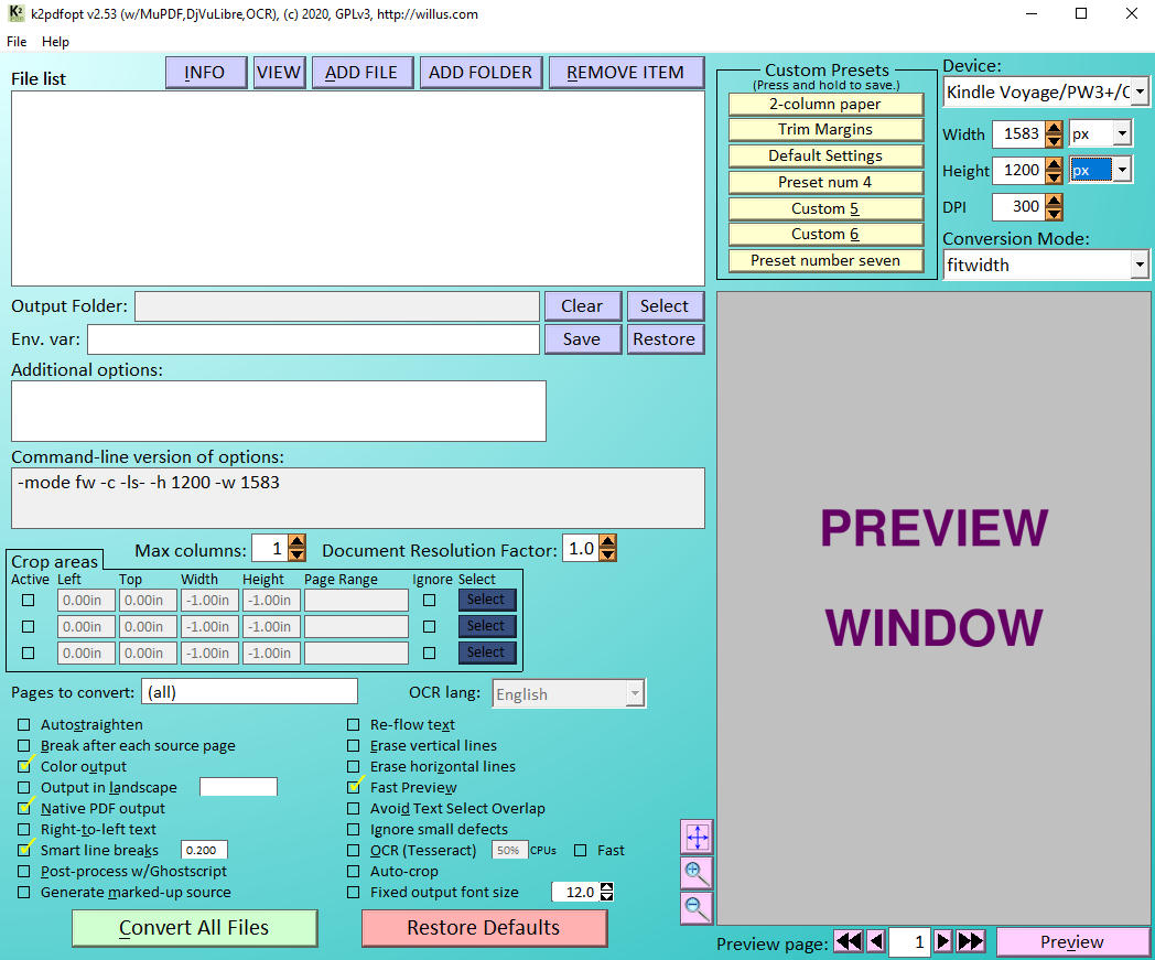

Thanks for the software!
I've converted a PDF using the fitwidth mode and it reads great on an Oasis 2. The only trouble is that in order to read the PDF in landscape orientation, I have to set the orientation on the Oasis 2 to portrait which makes highlighting things difficult. Does anyone know if there is there a way to use k2pdfopt to produce a PDF that will display correctly in landscape orientation on the Oasis 2?

You can see the dimensions used by the Oasis 2 by running this:
k2pdfopt -dev ?
Try just flipping the -w and -h values and turning off landscape:
k2pdfopt -mode fitwidth -ls- -dev ko2 -w 1583 -h 1200 ...
Or in the MS Windows GUI, select Oasis 2 and then flip the w and h values like shown in the screen shot.

Thanks for the response. I tried what you mentioned and the document displays properly when in landscape orientation. However there is a border around each page. This border wasn't present in the previous PDF I generated using just the fitwidth mode. Do you by chance know if it's possible to remove this border?

Do you mean a blank border? Or a black border? At this point it would help if you could post maybe a page or two of your source document so I could see what you are converting.
