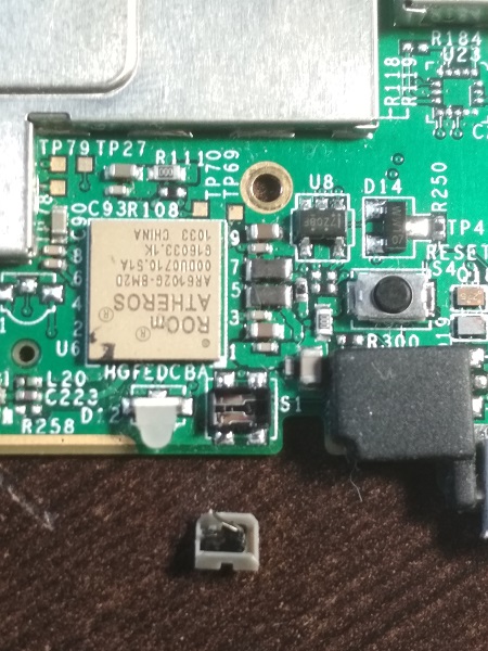

K3 has two common faults. The first is a stuck power switch, the second is broken balls under the CPU. To eliminate the first case, just open the switch, it is on the latches and extract the badge from inside. This model turns on automatically when the battery is connected, so nothing else is needed for testing. If it is not, try pressing your finger on the CPU and see if then the Kindle works longer. If so, 99% reflow is enough.

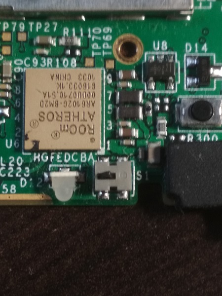

Noob here. My Kindle Keyboard suddenly started restart loops. After unsuccessfully trying all possible soft/hard reset methods, tried Kubrick and it "Finished" flashing at 6%. Now it doesn't boot at all and doesn't respond to any mode of reset. Just one unresponsive white page. Tried Kubrick again and now it doesn't get past 1% and says "finished".
I feel like I may have the same power switch problem. But I'm not sure what it means to disassemble the power switch. I'd really appreciate if any details can be provided on this.

Well, disassembly means disassembly :-) See the photos. Check the inside of the switch carefully. It likes to collect dirt, which makes a short circuit.

Thank you. I'll try this. I didn't realise you could take apart that tiny switch. Looks like I'll need some good magnifying glasses or a way to hold my phone in position in macro mode.
