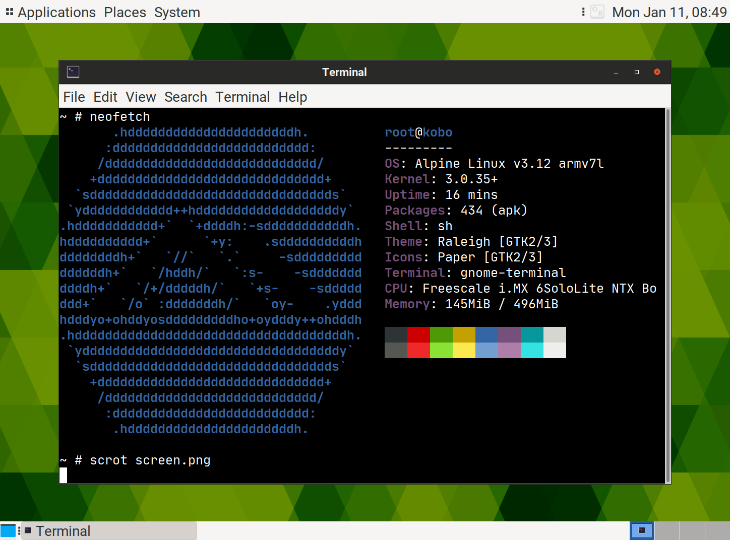

Hi,
As some of you probably saw in the Developers' corner, I started to make a preinstalled image of Alpine Linux with Xorg and Firefox in it to install it on a Kobo effortlessly.
I'm now here with a first release candidate of KoBox. It is *not* perfect, even the install process could not work (though it won't brick your Kobo, I'm fairly sure).

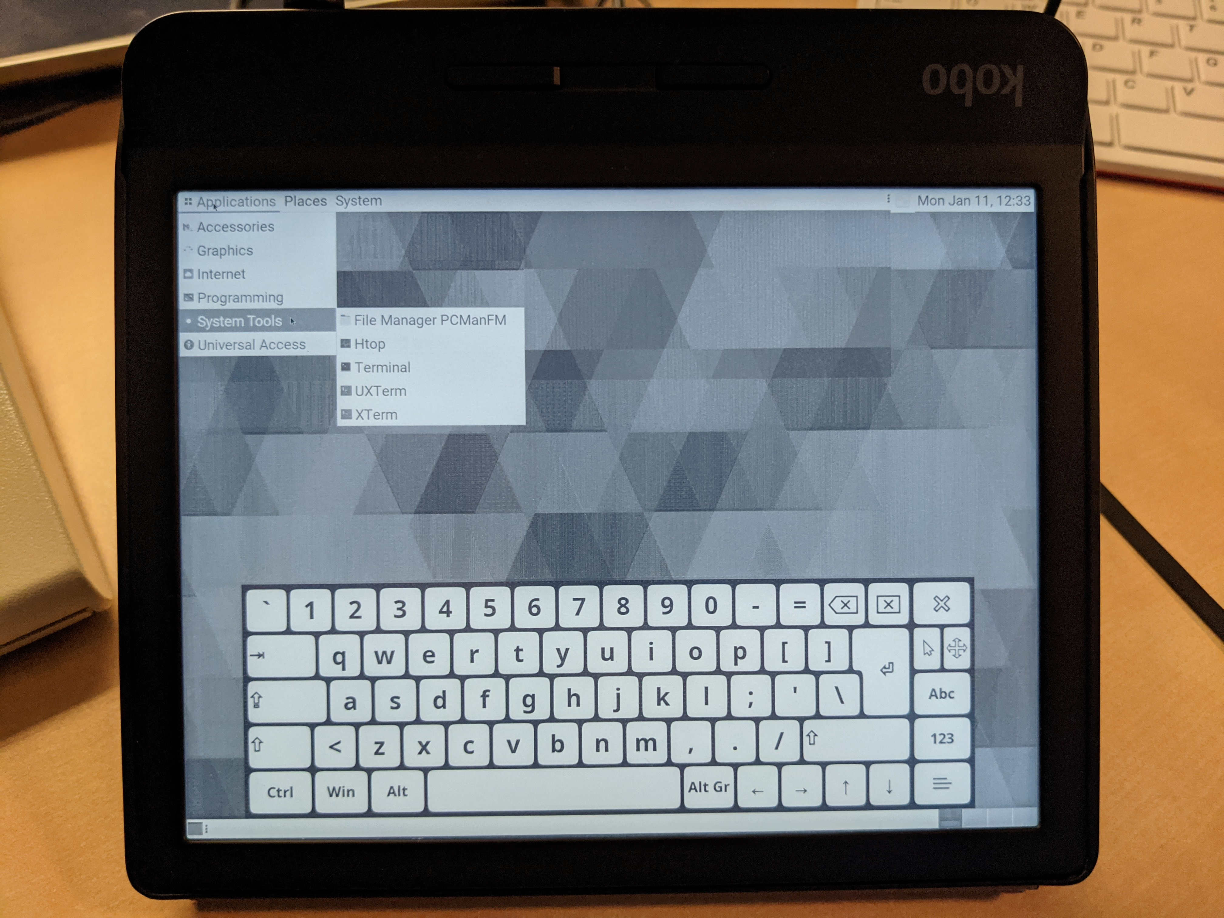

How to launch this? Normally, if all is correct and you extracted the contents of the kobox folder in your KOBOeReader partitions, you should see a thing called "NickelMenu" in the bottom-right of your Kobo's home screen. (BTW, thanks @geek1011). Ensure you're connected on Wi-Fi, then tap on it, and you should see something called "KoBox". Take a deep breath and click on it. Things should start to show on the screen. If you make it to the tiles wallpaper, you can already be pretty sure that it will work. Touch may not work right away. If the screen orientation is bad or touch is working strangely, do this on an SSH session to your Kobo (this will change in the future):
echo 1 > /sys/class/graphics/fb0/rotate
If you tap on the screen afterwards, things should work properly. *However*, your input device may not be what I programmed the script to listen for (/dev/input1). If so, please report it below. I will tell you how to get it working, if I can.

Kobo Libra H2O, Kobo Glo HD

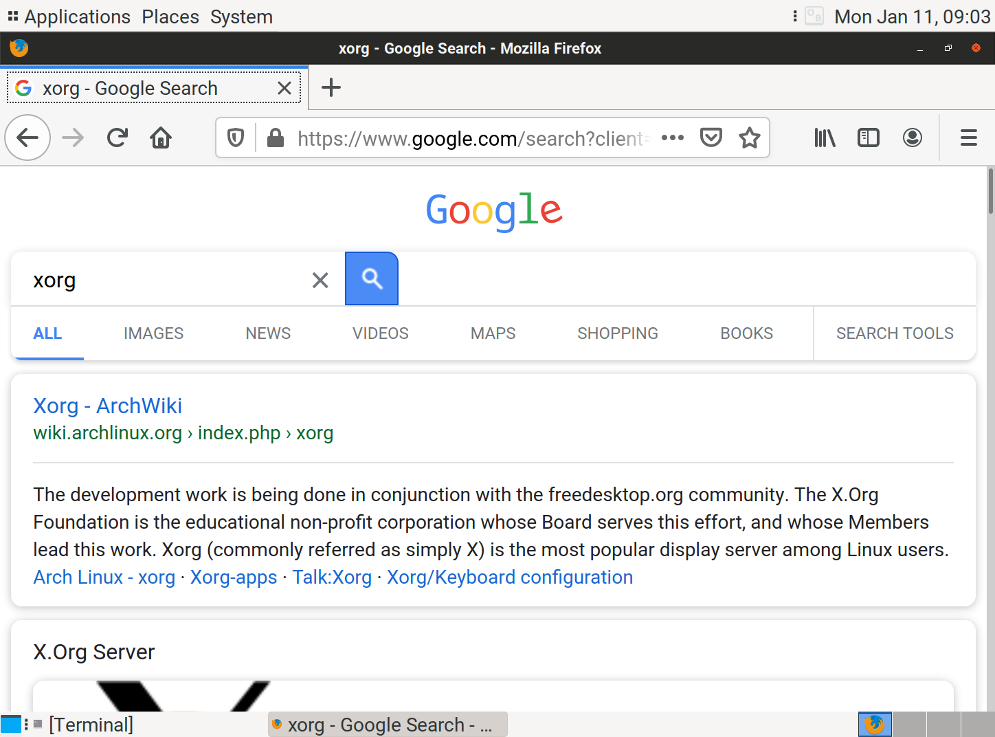

Programs included (not exhaustive): firefox, geany, xterm, uxterm, gnome-terminal, mate-panel, x11vnc, feh, idle3.8, python3, obconf, pcmanfm, nautilus, vim, nano, htop, onboard
Installable via apk (package manager), including, but not limited to: gcc, g++, clang, qmake, falkon, midori, epiphany
You'll *want* to install another web browser. Although Firefox is OK for short-term sessions, it has a preponderance to crash when used for a longer period of time. I recommend Falkon or Midori, or you can build Luakit from source if you're brave enough.
Example:
apk add falkon
to install Falkon
Things forgotten/to fix/to add/improve
- Fonts (Noto Sans Mono in Firefox is strange)
- Onboard keyboard
- Shutdown button
- Multitouch input
