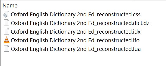

I have not installed a dictionary on a KOReader, and want to make sure I have this right. Do I copy all the files shown in the attached screenshot into the adds\koreader\data\dict\ directory? And after that, do I simply restart KOReader?

Old 01-30-2021, 10:10 AM   #3239
Posts: 82,240
Karma: 150871427
Turn on WiFi and use the dictionary download. It's under the magnifying glass icon in Dictionary settings.
Each dictionary in a dedicated folder in there would be better to keep things tidy, but, essentially, yes.
