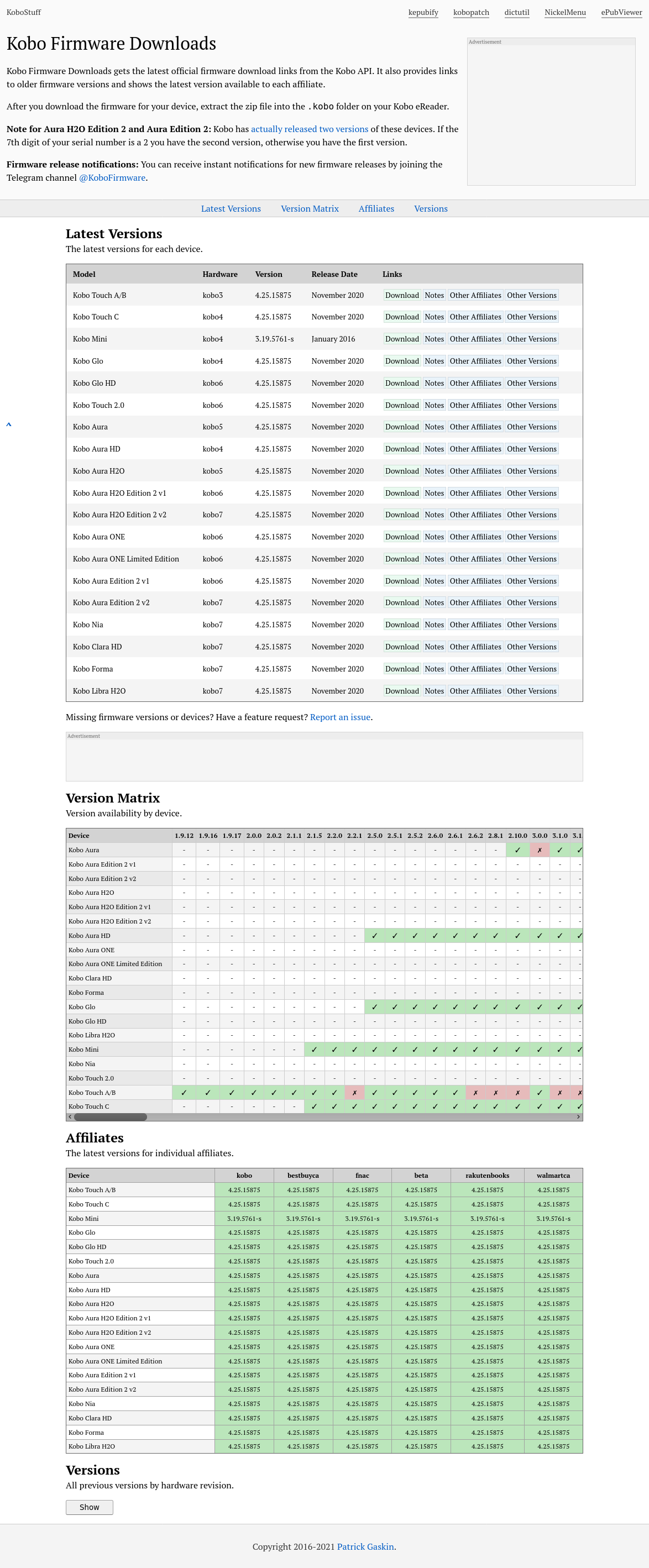

I've finally gotten around to finishing the redesign I've been working on for my Kobo firmware page for a while. It's now cleaner, more compact, and the tables are easier to read. In addition, there's now a dark mode for devices which support it. There's also now a second navbar to quickly jump between sections. Otherwise, the functionality is identical, but I plan on making some performance improvements later to make the page load faster.
Great! But how do I enable dark mode on the page?
Elektron is offline   Reply With Quote
Old 01-05-2021, 01:49 PM   #709
geek1011
Posts: 2,824
Karma: 7454317
Join Date: May 2016
Location: Ontario, Canada
In general, it's controlled by your OS settings (see here and here), but there are also browser extensions available like this one for Firefox to control it separately.
