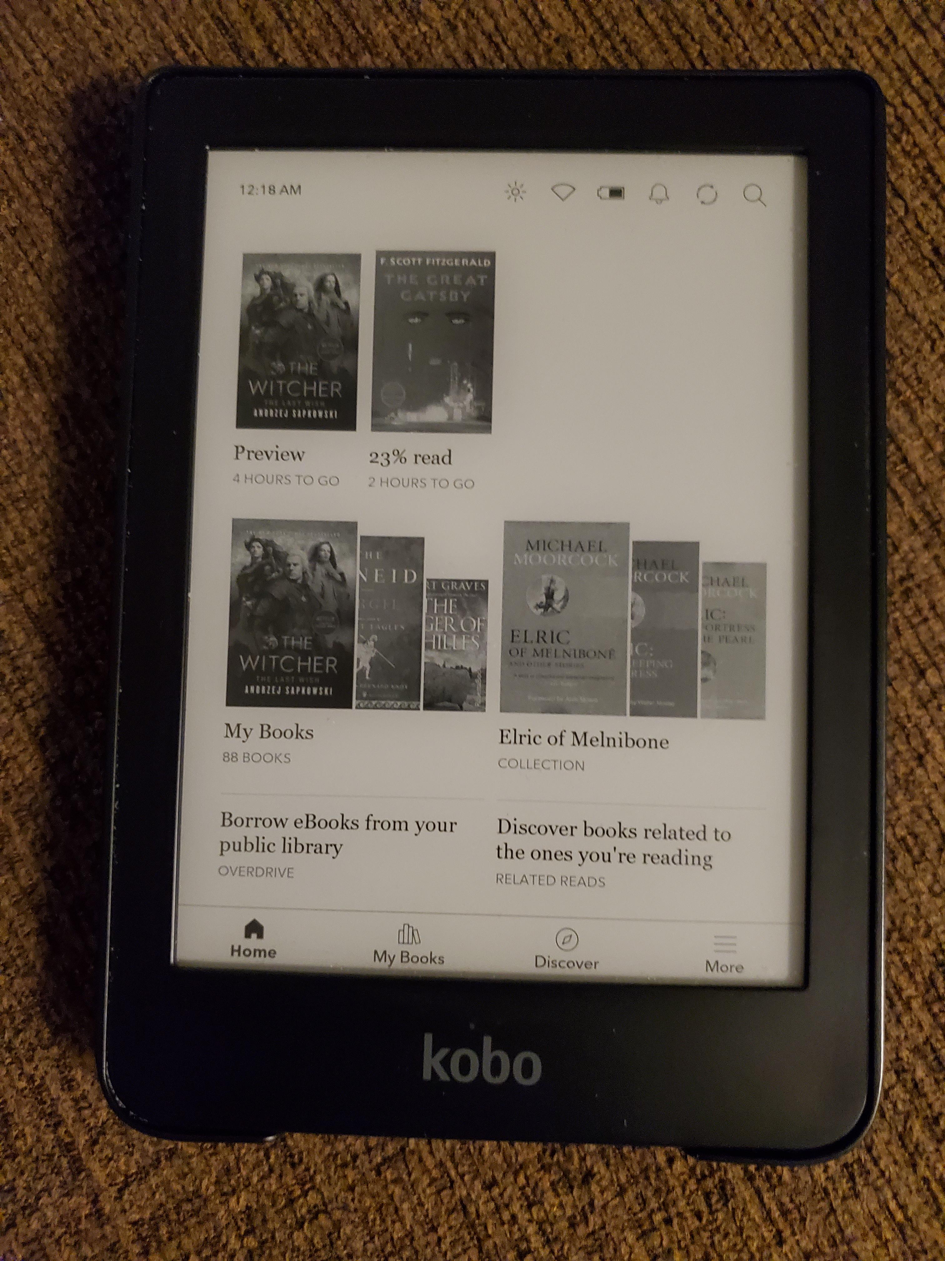

Clara HD - Battery Indicator Inaccurate
Usually when my Kobo is low on power, it will warn me that it's running low and to charge it. But on at least three separate occasions, I've had the thing completely die on me (e.g. the screen froze until I plugged it in), even though the battery had been at 50% or so when I last put it to sleep. When it happened two weeks ago I inadvertently factory reset the damn thing because I held the power button too long, which sucked, but I figured maybe that would at least resolve the freaking screen freezing problem.
No such luck. It happened again today, and I now have proof that something is very wrong here, because the frozen screen clearly indicates that it had 50% power when it inexplicably died.
Attachment 1: Kobo device completely frozen when I picked it up off my bedside table and lifted the official sleep case lid. I last used it maybe twelve hours ago this morning. You can see from the battery indicator icon that it was at least at 50%.

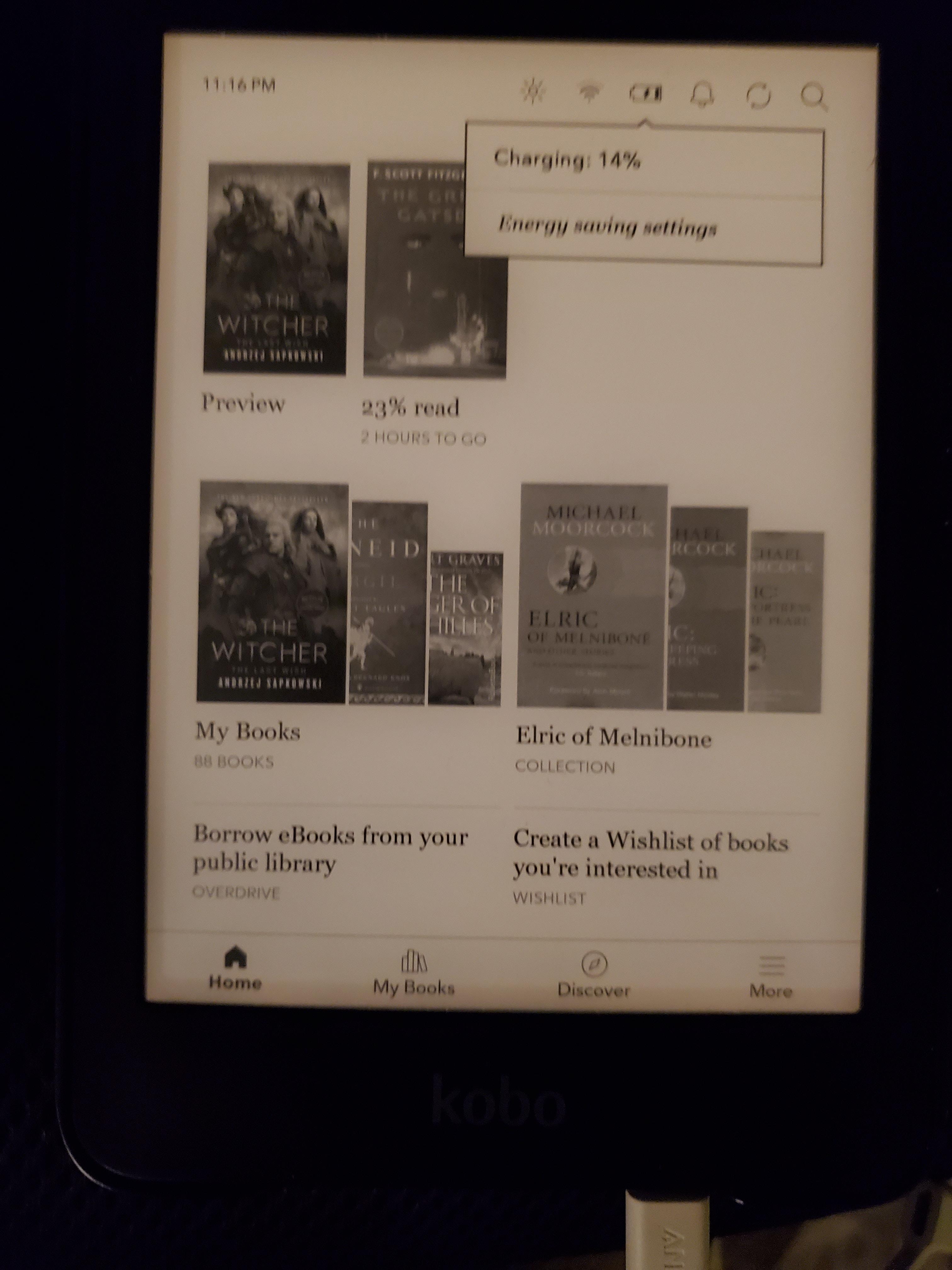

Attachment 2: Kobo device after it died and I plugged it back in. The device rebooted, the screen refreshed, and as soon I was able to interact with it again, I checked the charging status, and it was down to 15%.
I'm not sure what else I can do to troubleshoot here. I let the device fully discharge a couple of times in the past in the hopes that it would help calibrate the battery, but others advised that this was bad for the battery in the longterm, so I stopped. But this keeps happening, and it's getting incredibly frustrating, as I'll be sitting down to read a bit before going to bed, and then find my device dead.
Does anyone have any suggestions or next steps for this? My device is more than a year old at this point, so it's likely out of warranty. Will Kobo do anything for me if they deem the battery defective? I would've previously been concerned about losing my reading stats and side-loaded books and such, but since the inadvertent factory reset already happened, I don't have much to worry about in that department anymore. I just want the damn thing to work properly.

Batteries increase ressistance when going bad/get old and get higher voltage drops during current draw. So while it might have normal voltage with normal draw(like turning pages), the worst case draw can be just enough to drop the voltage below the limit that the reader would consider it empty and turn off so it doesnt overdischarge the battery.I have measured an aura one, and worst case current draw is almost double current than page turn(250ma vs 450ma).
Maybe a sync happened during sleep and draw just enough current that the battery cant handle anymore, which made it turn off. Do you have wifi on when this is happening? If so , maybe try turning it off when not needed, might eleviate the problem a bit.
If its out of warranty i doubt kobo would even look in its general direction.
Without any more info or ideally testing, it looks like you need a battery change.

@Cactus Chef: That is not likely to be a battery problem. That looks like the device hung for some reason or other. It could have been during a sync as @ReaLx3m suggests. Or something else. Depending on what happened, there could be a trace log in the .kobo directory which could give Kobo a hint of what went wrong.
Battery being at 15% when he plugs it , contributes to my theory and makes me think it is a battery problem. But hopefully those logs will prove me wrong, and the issue can be resolved with much less hassle.
Edit:Im assuming because he already factory reseted its not a software problem. But if we remove that assumption, yes , it can be a stuck sync that actually drains the battery in couple of hours.
