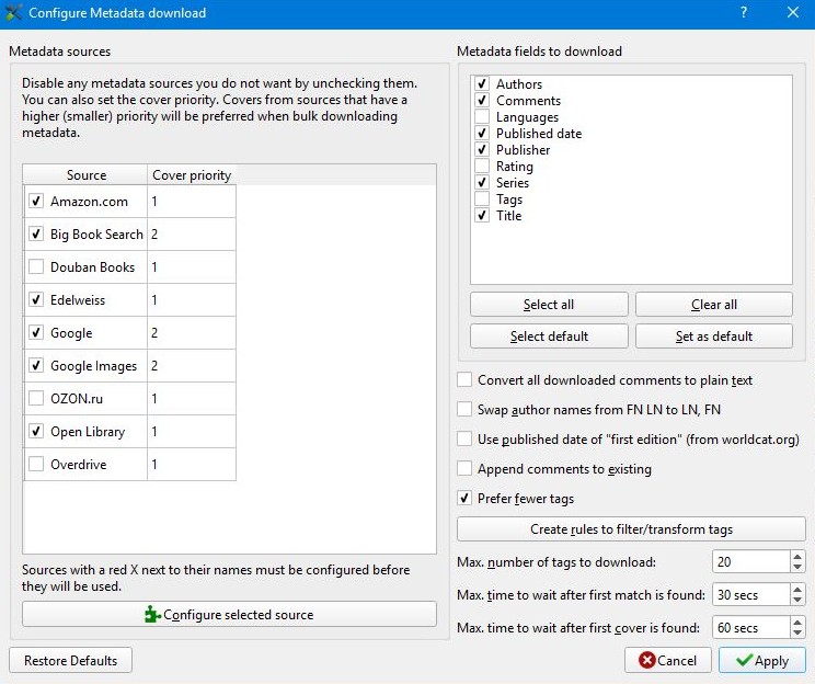

I've been mistaken, it was on the general metadata prefs page as shown here
I'd assumed that with Goodreads carrying both dates that it was a control for Goodreads Metadata Source. My Error.
I found thisin the changelog where that option has been removed from Goodreads in general. I'd previously always gotten the edition-specific date from Goodreads into the pubdate column and had used a separate column for the year of first publication of the work. I have to assume this change was the culprit.
For an example, when I'm looking up John Berger's Ways of Seeing via the ISBN '9780141035796' Goodreads Metadata Source pulls the date 1972, where the corresponding Goodreads page lists the first published date as 1972 while this specific ISBN was published in 2008.
If the ability to prefer either the first published date or the edition-specific date could be added to the plugin I would be appreciative but as it hasn't came up once in the time since I also appreciate the limits on the time and energy of people who maintain these projects.

That explains it. From memory, Worldcat was removed as the free version of the API was either removed, or restricted in ways that made it impractical for calibre (though I might be mixing that up with another site).
I suppose this hasn't come up as most people are more interested in the first published date. It shouldn't be hard to do. I'll put it on the list of things to look at the next time I need to touch the plugin.
That's what happened with Worldcat based on the digging I did.
Thanks for taking a look. The control for it being in Calibre but the effect of that control manifesting in the results from Goodreads Metadata Source makes me hopeful that the functionality is basically already in there.

The way that calibre handled this was simply to ignore the publishing dates from the other sources if that option was selected and Worldcat supplied a date. Each of the plugins have to decide how to handle each metadata field themselves. For Goodreads, there is code to look for "first published" in the book details and using that if it exists. It won't be hard to change that. Adding the option to the configuration and handling that will be more work.
