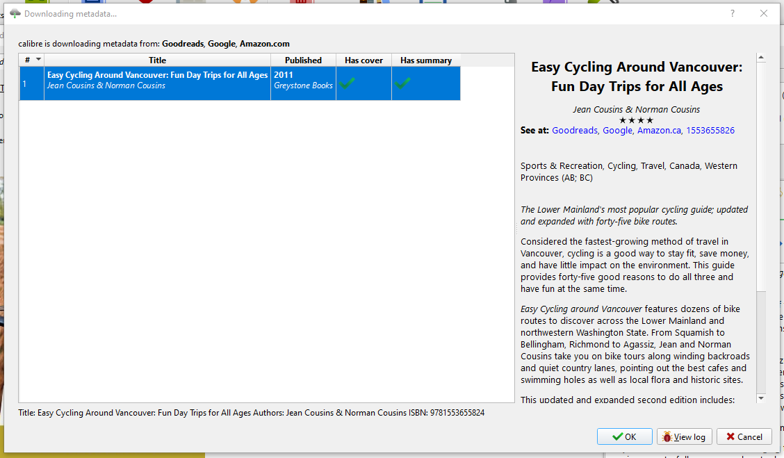

Old 12-02-2020, 10:13 PM   #538
davidfor
Posts: 24,905
Karma: 47303826
Location: Sydney, Australia
Originally Posted by bc4me View Post
Good Morning, newbie on the site here.
I just reinstalled the latest version of Calibre on Windows 10 after a PC reset. I'm having issues when I enable the Goodreads plugin.
On the 'edit metadata' screen, with metadata sources 'Google' and 'Amazon' selected, when I click 'download metadata' I get 2 separate unique entries, which is what I'd expect.
When I enable 'Goodreads' and click 'download metadata', I only get an entry from Goodreads, none from Google or Amazon to choose from. All 3 show information in the log.
Is there some option I'm missing? I'd like to be able to choose the best info, and still have all 3 links show in the 'Ids' sidebar.
Thanks for all the good work!
The metadata download can merge the results from multiple sources into one. But, if that is what is happening, it should show the identifiers for each of the sources.
Otherwise, I'd need to see the log to get an idea of what might be happening. Can you post it?

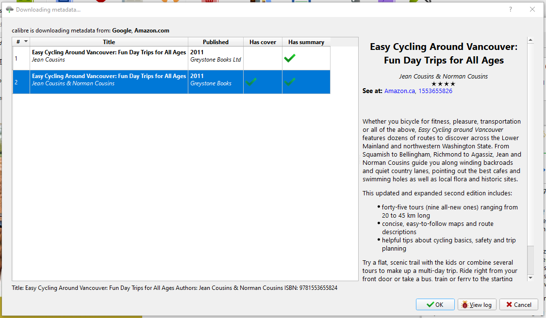

Old 12-03-2020, 12:40 PM   #539
bc4me
bc4me began at the beginning.
Posts: 4
Join Date: Dec 2020
Location: New Westminster, B.C
Device: KOBO Touch
Here's a couple of screenshots with Amazon and Google sources selected, then one with Goodreads, Amazon, and Google.
Name:	Screenshot 2020-12-03 080904 google and amazon1.png
ID:	183753   Click image for larger version
Name:	Screenshot 2020-12-03 080904 google and amazon2.png
ID:	183754   Click image for larger version
Name:	Screenshot 2020-12-03 080904 goodread, google and amazon.png
bc4me is offline   Reply With Quote
Old 12-03-2020, 12:42 PM   #540
bc4me
Posts: 4
Join Date: Dec 2020
Device: KOBO Touch
And here's the log with all 3 sources selected:

****************************** Google (1, 0, 1) ******************************
Found 1 results
Downloading from Google took 0.5918533802032471
Title : Easy Cycling Around Vancouver: Fun Day Trips for All Ages
Author(s) : Jean Cousins
Publisher : Greystone Books Ltd
Tags : Sports & Recreation, Cycling, Travel, Canada, Western Provinces (AB; BC)
Languages : eng
Published : 2011-12-15T16:12:17.951762+00:00
Identifiers : google:MSOaBAAAQBAJ, isbn:9781553655824
Comments : Whether you bicycle for fitness, pleasure, transportation or all of the above,Easy Cycling around Vancouverfeatures dozens of routes to discover across the Lower Mainland and northwestern Washington State. From Squamish to Bellingham, Richmond to Agassiz, Jean and Norman Cousins guide you along winding backroads and quiet country lanes, pointing out the best cafes and swimming holes as well as local flora and historic sites. This updated and expanded second edition includes: * forty-five tours (nine all-new ones) ranging from 20 to 45 km long * concise, easy-to-follow maps and route descriptions * helpful tips about cycling basics, safety and trip planning Try a flat, scenic trail with the kids or combine several tours to make up a multi-day trip. Ride right from your front door or take a bus, train or ferry to the starting point. Whatever your cycling interest,Easy Cycling around Vancouverwill fit the bill.
Making query: https://books.google.com/books/feeds...ewability=none
****************************** Amazon.com (1, 2, 14) ******************************
Found 1 results
Downloading from Amazon.com took 2.8911683559417725
Author(s) : Jean Cousins & Norman Cousins
Languages : eng
Rating : 2
Published : 2011-05-17T00:00:00+00:00
Identifiers : amazon_ca:1553655826, isbn:1553655826
Comments : <p>Whether you bicycle for fitness, pleasure, transportation or all of the above, <em>Easy Cycling around Vancouver</em> features dozens of routes to discover across the Lower Mainland and northwestern Washington State. From Squamish to Bellingham, Richmond to Agassiz, Jean and Norman Cousins guide you along winding backroads and quiet country lanes, pointing out the best cafes and swimming holes as well as local flora and historic sites. </p>
<p>This updated and expanded second edition includes: </p>
<ul>
<li>forty-five tours (nine all-new ones) ranging from 20 to 45 km long </li>
<li>concise, easy-to-follow maps and route descriptions </li>
<li>helpful tips about cycling basics, safety and trip planning </li>
</ul>
<p>Try a flat, scenic trail with the kids or combine several tours to make up a multi-day trip. Ride right from your front door or take a bus, train or ferry to the starting point. Whatever your cycling interest, <em>Easy Cycling around Vancouver</em> will fit the bill. </p>
<p>**</p>
User-agent: Mozilla/5.0 (Macintosh; Intel Mac OS X 10_14_4) AppleWebKit/537.36 (KHTML, like Gecko) Chrome/73.0.3683.86 Safari/537.36
Server: auto
Making google query: https://www.google.com/search?q=%289...Awww.amazon.ca
Ignoring div with no descendant
Failed to find any results on results page, with title: (9781553655824 or 978-1553655824) site:www.amazon.ca - Google Search
No search engine results for terms: (9781553655824 OR 978-1553655824)
Trying the bing search engine instead
Making bing query: https://www.bing.com/search?q=%28978...Awww.amazon.ca
Getting details from: http://cc.bingj.com/cache.aspx?q=%28...Es6cYc3nHCk3vS
The identify phase took 3.08 seconds
The longest time (2.891168) was taken by: Amazon.com
Merging results from different sources
We have 1 merged results, merging took: 0.00 seconds
Thanks!
