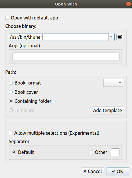

  • Open With: Similar to the open with plugin, but with some modifications. Used in this plugin it allows you to chain it to other actions. e.g. update timestamps

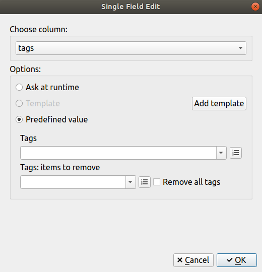

  • Single Field Edit: Allows you to edit the value of a single field for selected books. You can choose the value at run-time, or use a predefined value, or define a template.

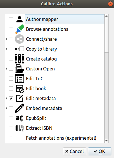

  • Calibre Actions: This action allows you to choose an action from calibre interface actions, for the purpose of chaining it to other actions.

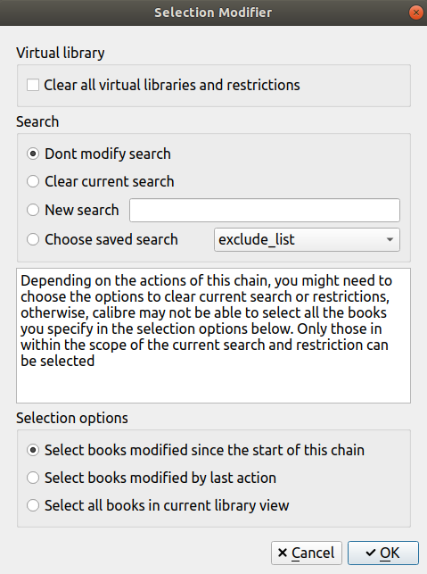

  • Selection Modifier: This action is useful when chaining actions together as it allows you to change the selections in calibre before an action. There are multiple criteria for modifying the selections. More on this below.

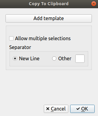

  • Copy to Clipboard: copy book metadata for selected books to clipboard. You choose the data copied by defining a template.

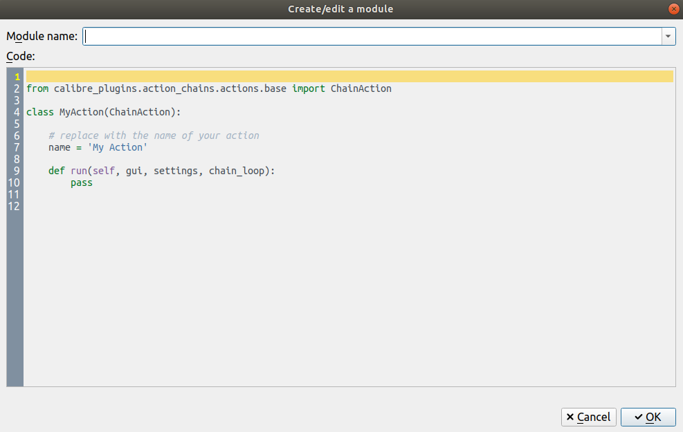

  • Run Python Code: For people who can program in python.

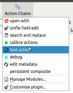

To make a new chain follow these steps:

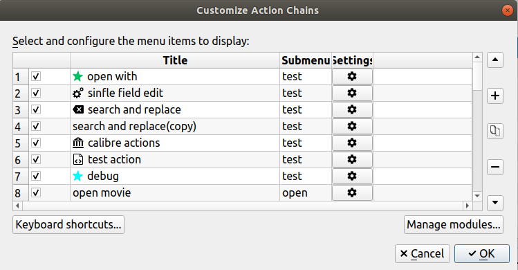

  • From the drop-down menu choose the "Add/Modify chains" entry to open the config dialog.
  • In the config dialog press the add button to add a new empty chain.
  • Double click on the name field to give the new chain a name, and optionally choose a sub-menu and an icon.

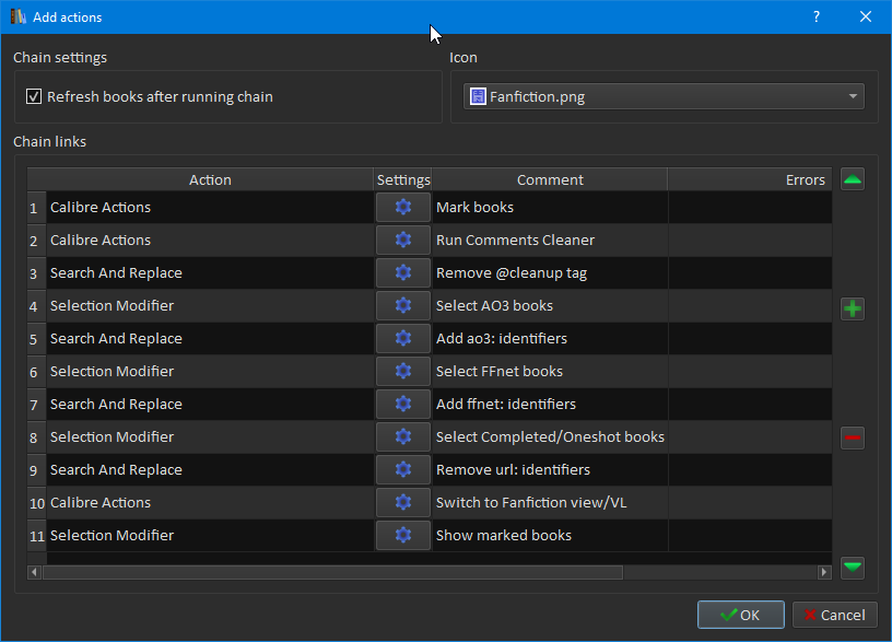

  • To start adding actions to the chain, press the settings button in the chain row, which will open the add actions dialog.
  • In the add actions dialog, press on the add action button. After this choose and action you want from the actions combo-box. Press the action settings button configure the action.
  • Repeat for all actions you want to add, and then press OK.

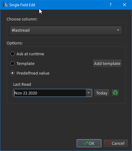

  • Adding a chain to edit the rating value and applying a custom last_rated_date timestamps afterwards. For this chain, you need two actions:
    • for the first action select Single Field Action and configure it by choosing the rating field and ticking the option to ask for value at run-time.
    • Add a second Single Field Action to apply the timestamps to your custom last rated date field. This time set it to a predefined value, then check the option "set to current time".
    Whenever you run this action through the menu or a keyboard shortcut, a rating dialog editor will pop up, choose the rating you want and it will apply to all selected books together with the timestamps.

  • You can use the template feature in the Single Field Action to setup persistent composite columns. Note however that while it might improve performance for huge libraries, you lose the convenience of composite columns being updated automatically, so you will have to run the chain periodically to update them.

Note on the Selection Modifier Action:
  • Since all the actions are selection dependent, the Modifier Selection Action gives you the option to change the current selection ahead of any action. You can choose only books modified by previous action, or you can specify search criteria to further narrow down you selections
  • If you choose a search to narrow down you selection, this will only change the current view of calibre to results of this search, so you need tick option "select all books in current view" together with the search.
  • Some actions may affect only some of the selected books. For example if you use the bulk metadata editor to remove certain tags, this action will only affect books that have that tags. If you want your next action to apply only to modified books (e.g. you want to add timestamp to only modified books), add a Selection Modifier to change the selections to "books modified by last action".
  • The point above applies to adding new books. If you want to select all books added by last action, add a selection modified right after the add action, with option "Select books modified by last action" checked.
  • For users who have the highlight search setting turned on, the selection modifier will temporarily turn it off, and then restores it back after it finishes. This is done to allow the "select all books in current view" option to work as expected when combined with a search.
  • Starting with version 1.6.0, the plugin introduced a new feature called scopes that can replace the functionality of the selection modifier. Note that not all actions support the new scopes feature, so some actions, most notably Calibre Actions, will still depend on the Selection Modifier specify which book they will act on.
Note on Module Editor:
  • For information on how to write your own actions, see the comments in calibre_plugins.action_chains.actions.base
  • Instead of making a plugin for every small task you want, you can use the module to add a custom action and add it to its own chain, which will get its own menu entry.
  • For examples on how to write a simple custom action, see here. Another example that illustrate how to add a settings dialog to a custom action can be found here.

This sounds almost like an exact solution to my post here. Definitely giving it a try.
Early feedback: One small feature that seems to be missing is the ability to add a descriptor/label to actions.
Works pretty well otherwise though. I'm experimenting with the selection modifier so I don't have separate actions for AO3 and FFNet fics.
Also, I found it's helpful to add a Calibre Action to toggle mark on all the books before starting a chain, and then at the very end setting a search to marked:true.
A small suggestion: It might be a good idea to have a custom action to prompt for confirmation for more...destructive action chains, and pressing "no" would halt the entire thing. I guess this could be made with a module though I'm not sure how.
Yes. I realized this after I've done it. First I needed to change the order of some actions, so I added drag and drop, but it is not perfect because it does not have visual indication of what is being dragged. So I thought adding identifiers might help.
I am thinking about rewriting it as a table to add identifiers and make changing order easier.
Nice. At least some extra use for Calibre Actions
As I pointed out in first post, I have not yet settled on how to deal with the control flow. But your request is simple enough to be used as demonstration of how to write custom actions, so here it is:
from PyQt5.Qt import QWidget, QVBoxLayout, QGroupBox, QTextEdit
from calibre.gui2 import question_dialog
from calibre_plugins.action_chains.actions.base import ChainAction
class ConfirmConfigWidget(QWidget):
    def __init__(self, plugin_action):
        QWidget.__init__(self)
        self._init_controls()
    def _init_controls(self):
        l = QVBoxLayout()
        self.setLayout(l)
        gb = QGroupBox('Confirm message')
        gb_l = QVBoxLayout()
        gb.setLayout(gb_l)
        self.tb = QTextEdit()
        self.tb.insertPlainText('Are you sure you want to proceed?')
        gb_l.addWidget(self.tb)
        l.addWidget(gb)
    def load_settings(self, settings):
        if settings:
            self.tb.setText(settings['message'])
    def save_settings(self):
        settings = {}
        settings['message'] = self.tb.toPlainText()
        return settings
class ConfirmAction(ChainAction):
    name = 'Confirm'
    def config_widget(self):
        return ConfirmConfigWidget
    def run(self, gui, settings, chain):
        message = settings.get('message', 'Are you sure you want to proceed?')
        if not question_dialog(gui, _('Are you sure?'), message, show_copy_button=False):
            raise chain.UserInterrupt

Here's a small glitch I found:
Single Field Edit > Predefined Value > Today on a timestamp column seems to have trouble with timezones.
I'm -4:00 GMT, and running an action at 3:30 pm produces a timestamp of 7:30 pm. Not sure what would happen if I ran it when the timezones are on different dates.
EDIT: Actually, it seems to produce timestamps of the time that the action was created....not the time it was run. Odd.
Sorry. I made a last minute change before posting that altered it. Can you try this one attached here and report back on it.
Edit: You will have to remove the action and add it again.
Last edited by capink; 11-21-2020 at 03:32 PM. Reason: attached version moved to first post

Thankfully I only have the one. "Mark as Read" sets #read to yes, #percentread to 100, #lastread to the current time, and pops up a rating dialog.
