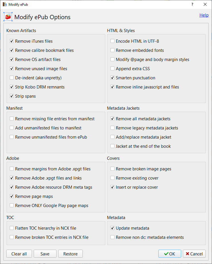

2) Question for anyone, but what does Calibre's Embed Metadata button do? Compared to Modify ePub.
Embed Metadata updates the metadata in the file. You can take a look at Modify ePub's options when you click on it to see how much more it can do. I've attached a screenshot of the options here. The only other customization it has is if you want to be prompted to save the modified epubs.
