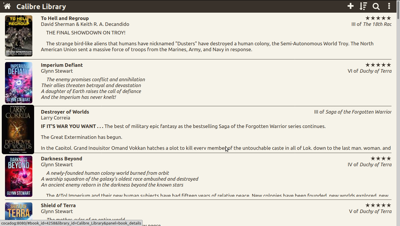

This is the command I use on my linux pc to start the server using the book list.
calibre-server --book-list-mode details_list
bernie
Name:	Screenshot from 2020-10-28 15-10-32.png
