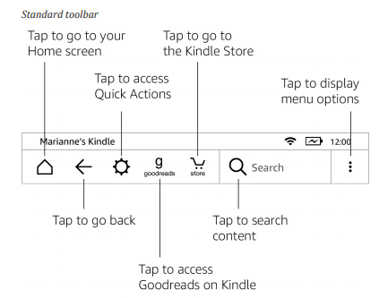

Originally Posted by ghmerrill View Post
Really? How does that work? I don't see how linking to the same destination from several different locations is supported by the model they present of how to code reference and footnote links. I haven't seen any examples of it. Can you provide details or a reference for how to do that?
A single citation linked from multiple places is not going to work like a popup footnote.
See the second icon in the attached image of the Kindle standard toolbar. It works like the back button on a web browser.
I don't see how this corresponds to the case I described -- which is multiple footnote links to a single footnote. Not a single footnote link to multiple footnotes -- which makes no sense to me.
Can you provide an example in the basic implementing HTML of what you're talking about? I just don't get the relevance of the toolbar display when (I thought) we're talking generic footnotes in standard etext. I'd like a description of HOW this works (whatever it is) rather than a picture of a UI in which maybe it's been implemented. Thanks.
ghmerrill is offline   Reply With Quote
