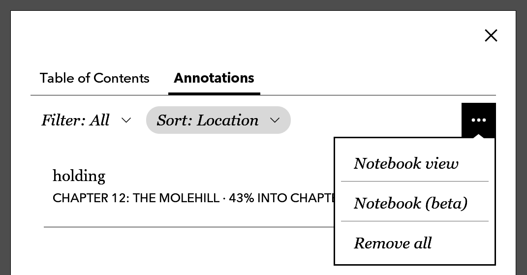

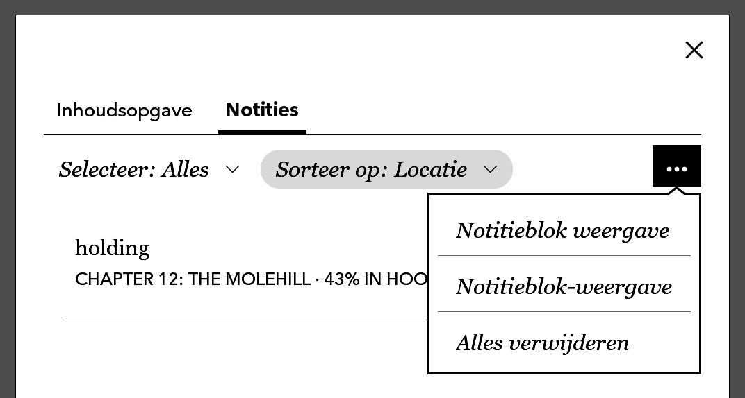

Not "really" a bug, but when selecting as main language "Dutch", you get the impression that the same annotation menu option is available twice, while, for instance using "English" as the main language you then see the "beta" indication for the 2nd annotation menu option.
The menu is not properly sized, or sized maxed and chopped of the "beta" I guess.
