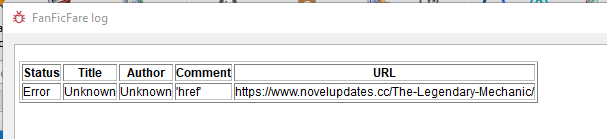

New Test Version Posted
2020-09-16
- New Site: novelupdates.cc (possible transition dest for wuxiaworld.co?) - Thanks ElminsterAU!
I tried https://www.novelupdates.cc/The-Legendary-Mechanic/
and got an error message.

Do I need to config something in personal.ini?
Attachment 181991
I've opened an issue for this: https://github.com/JimmXinu/FanFicFare/issues/555
