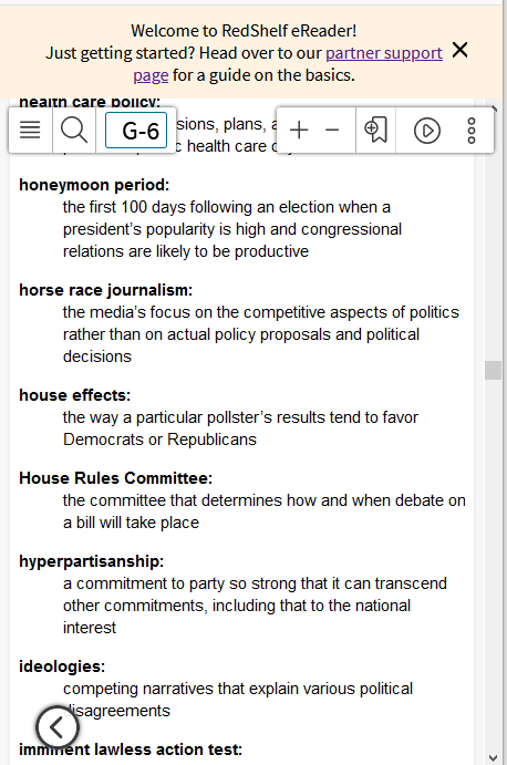

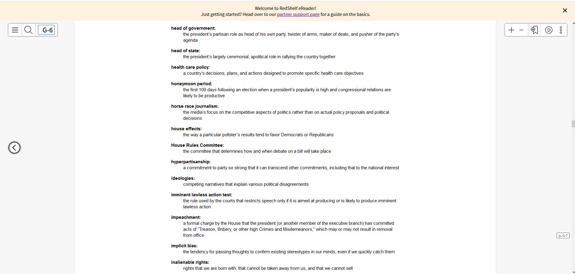

Originally Posted by najgori View Post
When I click "Try It Now" I get AmGov by Christine Barbour and it is scrollable, not reflowable and it is not fixed layout.
It looks like every chapter is one long rotulus where you scroll up and down, so it is not reflowable - perhaps that is the way that javascript renders epub, but without original epub I don't know.
When I tried the RedShelf try it now, it was reflowable. When I shrank the web page, the text reflowed. I've attached a couple of images of what I saw.
ID:	181949   Click image for larger version

Join Date: Aug 2007
Location: Grass Valley, CA
Yes, and the mobileRead web page is reflowable exactly the same way. It is displayed as HTML in a browser.
