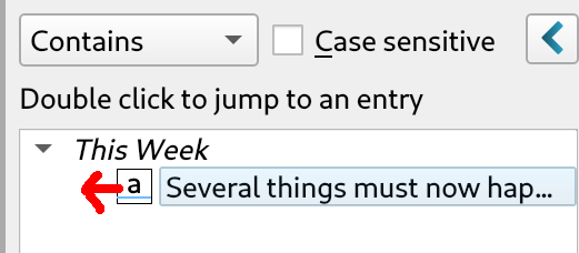

Bug 1: Clicking 4-times on text in Firefox on the text will deselect the text you are clicking and select the next line.
Bug 2: If you select an image, the image will be blue.
Suggestion 1: Add the ability to search the Bookmarks panel.
Suggestion 2: Add the ability to change which search engine to use for Search for selection on the net function.
Suggestion 3: Show the Style name as tooltip when hovering the Style in the Add notes window.
Suggestion 4: Display highlights per chapter in the server viewer highlights panel similar to the ToC panel.
Suggestion 5: Move the style and highlight entry closer to the left edge in the panel to make room for highlight. See attached image.
