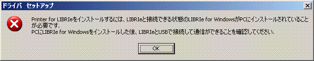

Okay, here we go.
  1. Run Printer for LIBRIe installer (setup.exe)
  2. Wait until it displays an error messagebox (it says you need to have Librie connected):
    Don't click it away yet.
  3. Go to Control Panel and open Printers and Faxes.
  4. Click "Add a printer" in the panel on the left or choose File|Add printer
  5. Click "Next".
  6. Choose (o) Local printer and deselect [ ] Automatically detect and install my PnP printer. Click "Next".
  7. From the list of ports choose "FILE:". Click "Next".
  8. On the driver list screen, click "Have Disk..."
  9. In the "Install From Disk" dialog, click "Browse..."
  10. In the filename field, type %temp% and press Enter or click "Open".
  11. In the list of folders choose the one that has a name of format "{XXXXXXXX-XX....XXXX}". If you have several, switch to details view, sort by "Date Modified" and choose the most recent one. There will be another folder, go inside it too.
  12. Choose bbeb.inf and click "Open".
  13. Click "OK" to close "Install From Disk" dialog. "Printer for LIBRIe" should appear in the list.
  14. Keep clicking "Next" and "Finish" to install the printer.
  15. You can now click away the installer's error message.
Recommented default settings.
  1. Right-click your new printer and choose "Printing preferences".
  2. From "Paper size" choose "LIBRIe".
  3. On the "Other" tab, set "Color" to "Grayscale" and "Output to memory stick" to "OFF".
  4. If you set "Output size" to "2Size fit", each page will be rotated 90 degrees and split in two.
When printing to Printer for LIBRIe, you will be asked for a filename to save the result to. Make sure you add .lrf extension to it so that Reader will recognize it as a BBeB book.
