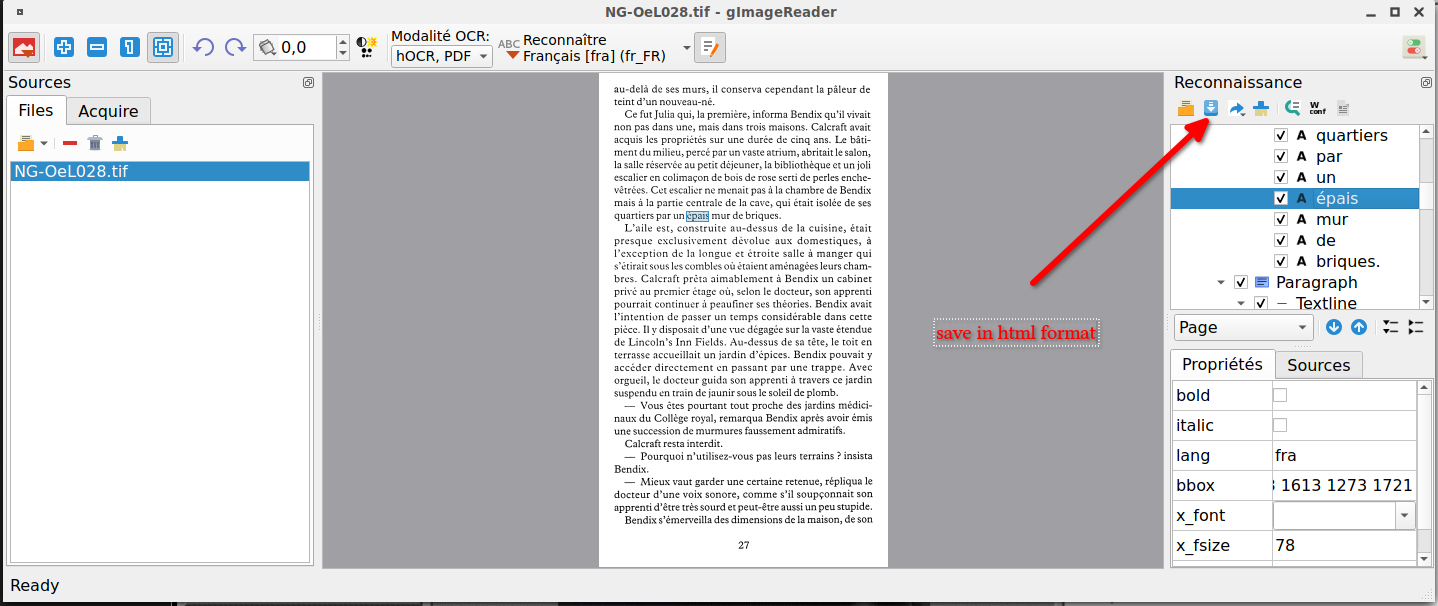

I also use Gimagereader-qt5 with Archlinux. Mine looks slightly different.
See screenshot
I process only .tif images coming from Scan Tailor.
I recognize text in HOCR format by blocks of 70 pages max
I save in html file (see red arrow)
I insert the block file in LibreOffice and save as odt.
Each block has a 3 mega size max
I suppress all bookmarks and sections, block by block.
the result is a clean enough odt file that will be later converted using ODTImport (a Sigil plugin).

  • Left/Center/Right alignment
And with Sigil/Calibre, you have access to more powerful tools/Regex.
For example, one of my favorite tricks is still to search for all hyphenated words in the Spellcheck Lists (I wrote about that all the way back in 2013!).
And now that "numbers are words", you can use a similar trick to find whole classes of OCR errors (0<->O, 1<->l). (See "Suggestion: Spellcheck Enhancement (Numbers)").
5. Run through a final Spellcheck/Grammarcheck pass
See my 2018 post in, "Does Tool Exist to Spellcheck/Grammarcheck by Category?".
If you spellchecked in Sigil/Calibre, maybe try Word (different dictionaries may point out other misspellings).
If you grammarchecked in Word, maybe try LanguageTool or Antidote. Different tools might catch different errors.
And I definitely run EPUB Tools's Dialogue Check—it's the best damn thing since sliced bread, and it catches all the mismatching quotation marks + parentheses/brackets.
Originally Posted by patrik View Post
You have no idea how many notes I have due to your posts.
I'd be interested in learning what sorts of things you marked down in your notes.
I've been trying to put together an "FAQ"-type series of posts for the blog... and I have no idea what sorts of things people found useful over the years.
PM me if you don't want to type about it here. (Wouldn't want to derail this thread.)
