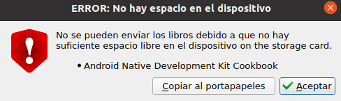

Hi. I'm playing a bit with the API of "smart device app" to improve KOReader wirelessly connection with calibre. So far so good but I have a couple of questions related to free space on disk:
1. It seems that the smart device app ignores reported free space. It does not raise FreeSpaceError as indicated in https://github.com/kovidgoyal/calibr...erface.py#L389
2. I can live with (1) because calibre reports the length in bytes of each file, so I can compare it with device free space. I don't know if there's a way to tell calibre that one or more specific files were not received by the client.
In the best case scenario I would want the server to report issues like "connect to folder" device is doing (in attachment) but I'm fine if the server doesn't report any error as long as it could report the files already on-device.

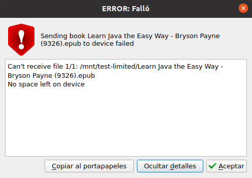

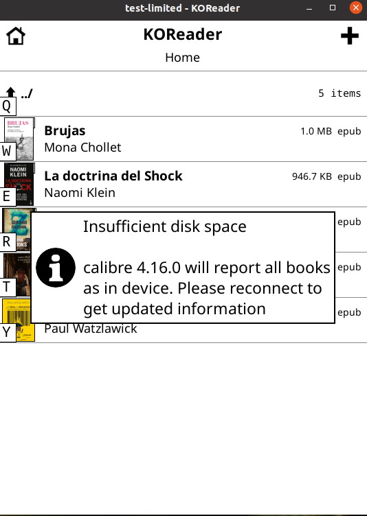

  • If the client returns ERROR (val 20) to SEND_BOOK then the driver will raise a ControlError exception. The return dict can contain an entry 'message' that will be included in the exception. In this case the driver will not start sending the book data.
  • Add the sanity check that checks device free space against the book size(s)
I have committed the above changes. Once Kovid accepts them then they will be in calibre source for you to test.
Thank you!!!
With the sanity check in place everything seems to work just fine. In order to test the user feedback I modified the reported free disk space in response to FREE_SPACE opcode. It works too (attachment #1)
For legacy calibre versions I didn't found a better way to handle no disk space than send all binary data to the void and report a message asking the user for disconnect and connect again (attachment #2). Obviously it would be better if I could manage to send the book count again without reconnecting, but I'm fine with the solution.
