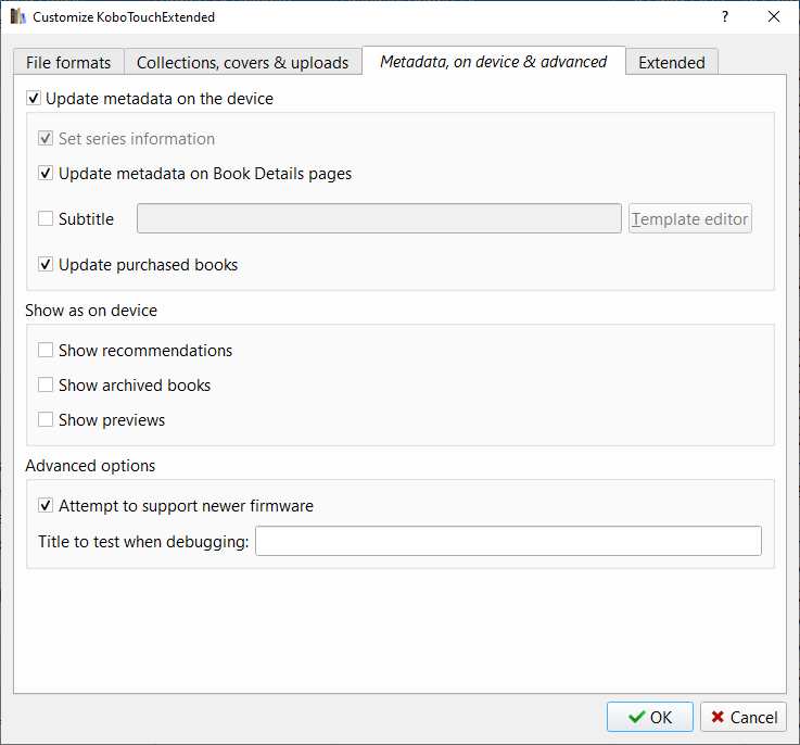

Hi there, I seem to have a strange problem and I'm not quite sure if I just have some miss-configuration on my end:
When using the default KoboTouch driver (With my Libre) to copy over ePubs, no series are displayed on my Kobo, but collections are created.
When using KoboTouchExtended to copy over KePubs, I have the same behaviour, BUT: If there are already some ePubs on my Kobo that originated from the default KoboTouch driver, and I just use KoboTouchExtended to rewrite metadata, the suddenly I get perfectly nice series information on by Kobo! And it works flawlessly, the correct sort order is applied and everything. BUT: This applies only to the existing ePubs. All KePubs don't get series information.
So this is a strange situation, I would absolutely love to have correct series to show up, but currently for that I would have to:
Use KoboTouch to copy all ePubs over, switch to KoboTouchExtented to rewrite Metadata, don't use any KePubs.
Is this a known Problem? Is there a way to get series working for KePubs?
Thanks.
pad01 is offline   Reply With Quote
Thanks.
Series should work using either driver. Two caveats are in calibre's preferences/Sending books to device, make sure the Metadata management is set to Automatic management and that you need to connect twice (the first time you send the books, safely eject and let your Kobo import them, the second connect now has database entries to update). Otherwise, check the 3rd configuration tab (Metadata, on device and advanced) for both the KT and KTE drivers and make sure they are set the same. I've attached an image of what mine looks like -- basically, the Set series information checkbox needs to be checked. You can disregard the Advanced options, that setting is just handy when Kobo updates and the calibre driver has not been updated.
