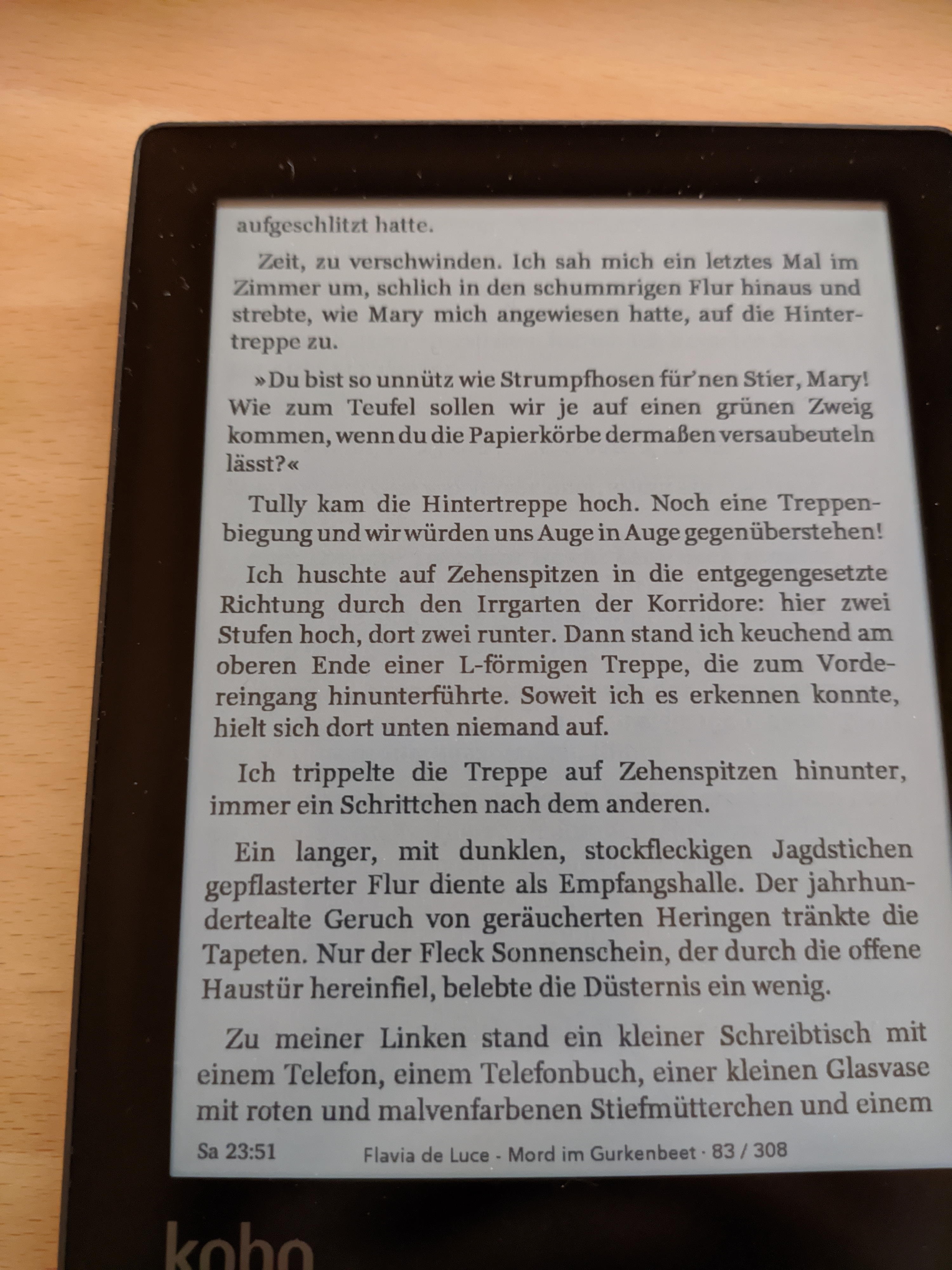

@frostschutz I put the AndinkaInk Regular.ttf Font in the Miniclock Directory, increased the _px Size to 56 but Time still does not change. I also removed the Date.
