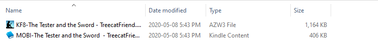

An alternative to converting with calibre is to use the KindleUnpack plugin to separate the mobi/KF7 and azw3/KF8 components. A bit messy but probably a cleaner result than a calibre conversion. See image for the result of splitting my test file.
