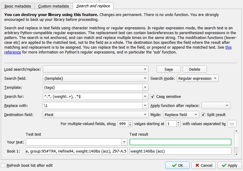

Like this.

The regular expression needs to account for the position of the desired field in the string. which can be first, middle, or last. For example:
^(.*?, *|)(weight:.+?|)(,.*?|)$
The above expression doesn't work if there isn't a "weight:...." tag somewhere in the list.
I leave it to you to figure out how to change the expression you use to delete the tag from the tag set. The change will be similar.

is it possible to excude the "weight:" text from moving to the other field?
test: "case:AR5steel, light, group:Fractal-group, weight:@seventyOne'Kilos, Xeon, ZRX0, ZRX4"
result: "weight:@seventyOne'Kilos"
The result am looking for is "@seventyOne'Kilos".
Yes. Move the parenthesis of the second group to where you want.
I suggest that you do some experimentation with patterns to see how they work.
Thank you very much. These work just like I wanted, much appriciated for your help.
^(.*?, *|)weight:(.+?|)(,.*?|)$
\2
then
\1\3
