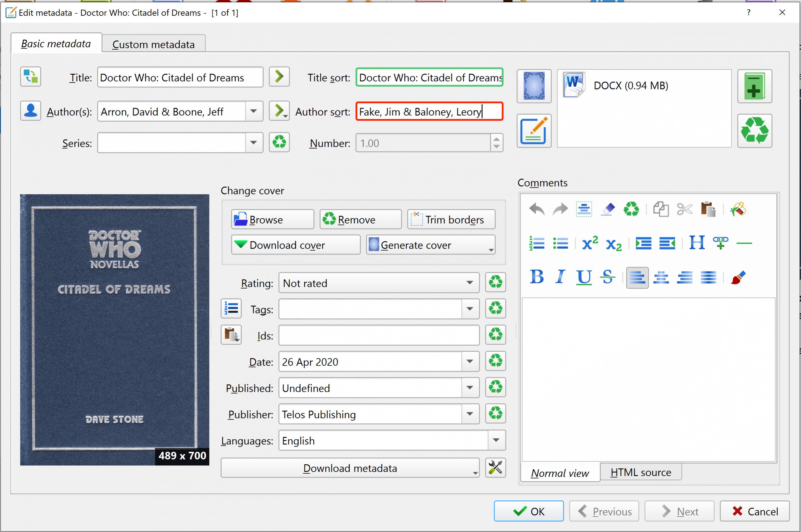

This is a great suggestion. Thank you very much. I just tried it with interesting results...
I entered the genuine authors' names in the "Author(s)" field and fake names in the "Author sort" field.
When I dragged-and-dropped the file via USB to my Kindle, both the correct authors displayed. That tells me @jhowell is correct -- Kindle ignores the "Author sort" field. It's also interesting to note that both authors' names appeared.
Next I emailed the file to my Kindle. In this case, my Kindle displayed the real author's names, but only the first author. This is further verification that Kindle is ignoring the "Author sort" field. But more importantly, it tells me the second author's name is being dropped when I email it. The Amazon server must be stripping it? I've test two books so far and I'll test a few more books. If this pattern keeps up, I'll contact Amazon.

As a side note, when I created thes test mobi files with fake names in the "Author sort" field, Calibre generated folders for them with BOTH authors' names.
Previously in this thread when I said that Calibre has created folders using two authors names, multiple people insisted I was wrong -- that will never happen.
Ultimate this is a non-issue. I was just a bit insulted that no one believed me. So here's your proof in the attached photo.

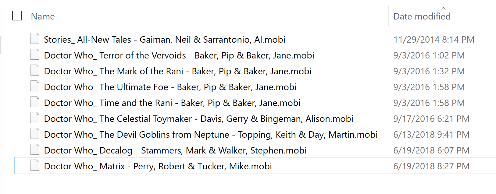

That is really interesting. This is a bit off subject, but could you do a screen shot of the calibre gui of the book's metadata so I could see how you've inputted that?
No worries if you don't feel like it...
i second that request. I wonder if its a mobi-only bug/feature. I looked through all of my own library and the only case I found was because a comma had been used in place of an ampersand. But my library is 99% epub.
Sure, here you go.
Notice that the folder names are based on the fake names in the "Author sort" field, rather than the real names in the "Author(s)" field.
This might explain why the folder names changed for me. Back when Calibre was properly maintaining two author names in the "sort" field, the folders always had two names. Now that Calibre is mysterious dropping the second name from the "sort" field, the folders are also usually dropping the second name. My guess is, once the bug is fixed so that the "sort" metadata maintains both names, my Calibre folders are going to go back to regularly having two names.
I'm also reattaching the snapshot I took earlier to show that my file names typically have both authors as well.
