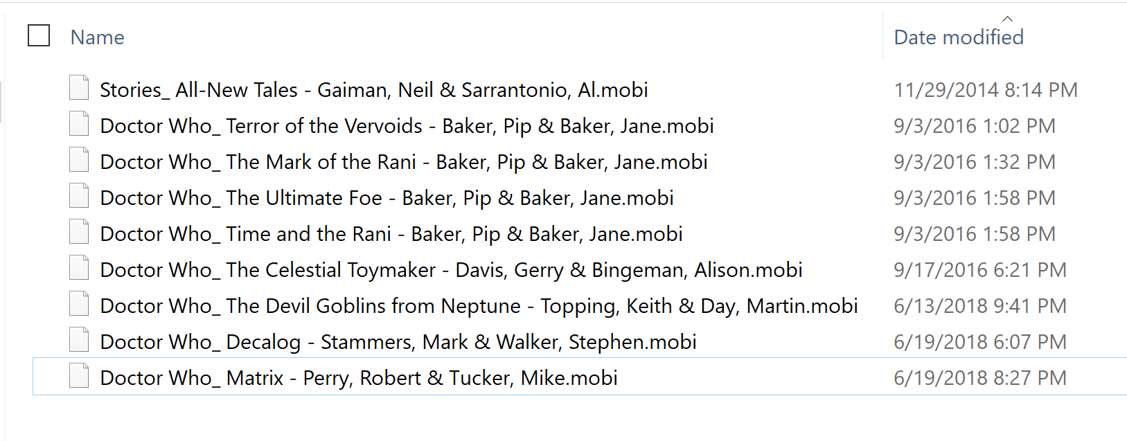

Here is my first screen shot. It's a sample of mobi files created by Calibre from 2014 through 2018. (Specifically, I'd imported Word docs and epubs, edited their metadata, and converted them into these mobi files).
The file names were auto-generated by Calibre. As you'll see, Calibre added both authors' names to the file. (You may noticed that they are Last-Name-Comma-First. There's a reason for that, but I don't want to get side-tracked on that issue right now.)
However, any ebook I create now has only the first author's name.
PLEASE NOTE: I'm providing this screen shot only to prove that I am not crazy (many people suggested I was wrong when I said Calibre would add both authors' names to the file). Ultimately, I don't care about file names. All I care about is the metadata. I mentioned the change in file naming convention merely only because I thought it may be related to missing metadata I'm experiencing. It's possible they have nothing to do with each other.
With that in mind, my next post will be the important one because it will provide screen shots of the missing metadata. So if people want to ignore this post, that's fine by me.

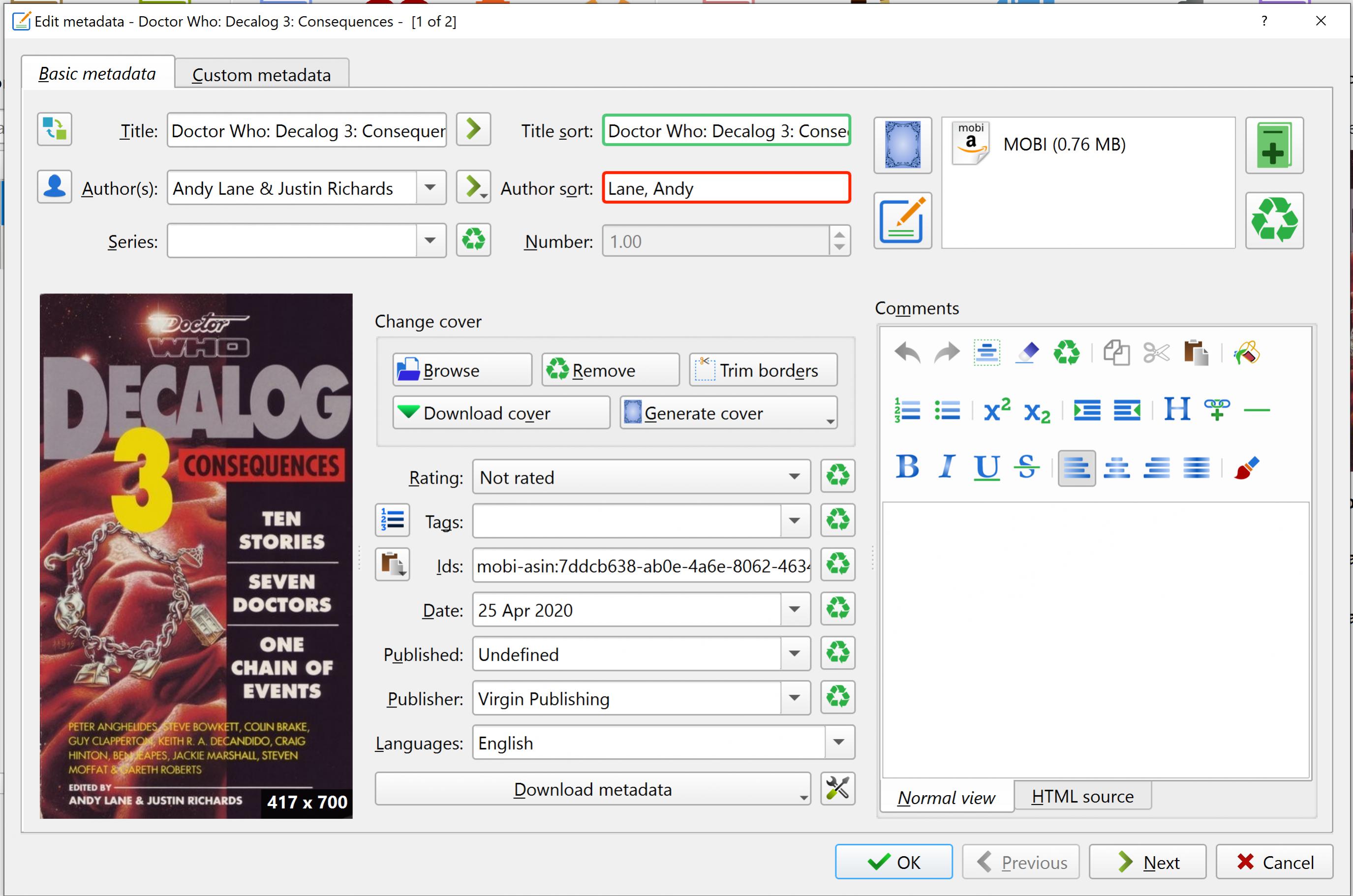

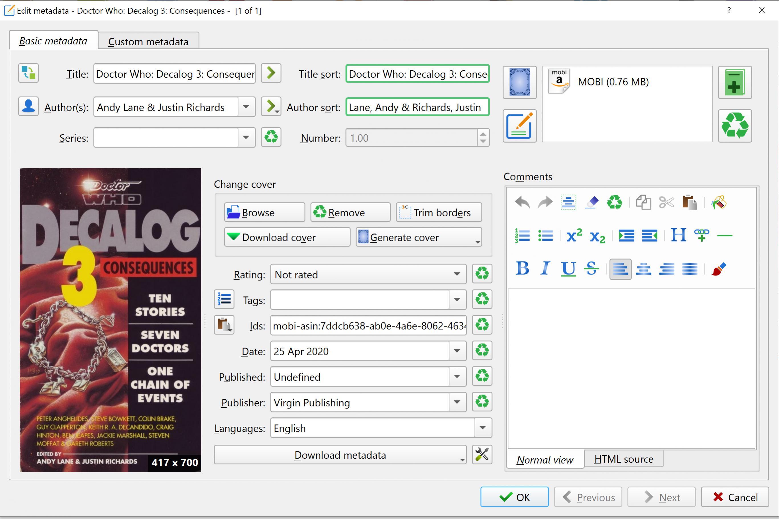

SCREENSHOT 1:
I imported a Word document, manually edited the metadata, and converted it to a mobi file. Here is the screenshot of the Calibre GUI as it appears. Everything looks fine -- both the "Author(s)" field and the "Author sort" have two names. You'd assume the file metadata is correct.
However, I test this with the following steps:
1.) I find the .mobi file in my Calibre Library. I right-click to copy it. Then I save the copy to my desktop.
2.) Then I add the desktop copy to my Calibre Library as though it's a new book. Note that this is the file as-created by Calibre. No further processing has occurred. I've not exported it to a device or directory. So all the metadata should be there. If any is missing, then Calibre didn't include the metadata when it created the new file...
...which you can see in SCREENSHOT 2 turns out to be the case.
Both authors' names are in the "Author(s)" field, but only the first author's name is in the "Author sort" field.
And if I load this book to a Kindle, only the first author's name will appear.
Perhaps in theory the missing second name from the "Author sort" field shouldn't matter... In terms of the information my Kindle displays, it should be relying on the "Author(s)" field, which has both names... The missing name in the sort field should, in theory, simply mean, at most that second name isn't used for sorting purposes... but I can assure you that my Kindle stopped displaying the second author's name and the same time the second name began disappearing from the "Author sort" field.

Device: Kindles
I did some testing and was able to duplicate some of what A Lurker is seeing with importing MOBI books into calibre.
I created two books in MOBI format by conversion in calibre with with two authors each. In one I chose the option to "Use author sort as author" and for the other I did not. I used a MOBI file dumper to verify that both author names were in both MOBI files. The first file has the names stored in "last, first" format and the second had the names stored in "first last" format. This is as expected.
I then copied the files from the calibre library and re-added them as new books. Both books imported with both author names shown in "first last" format in the author field (first1 last1 & first2 last2).
However the author sort field came out different in the imported books. The book that had names stored in "first last" format showed both names in the author sort field (last1, first1 & last2, first2). But the other book, with names stored internally in "last, first" format, showed only the first author in the author sort field (last1, first1) marked in red. So there does appear to be something going wrong with author sort during the calibre import of that book.
EDIT: Public domain book that demonstrates the problem attached.

Old 04-26-2020, 01:32 AM   #43
Posts: 45,919
Karma: 29579516
@jhowell: This should take care of the author_sort issue: https://github.com/kovidgoyal/calibr...a396a74577603c
