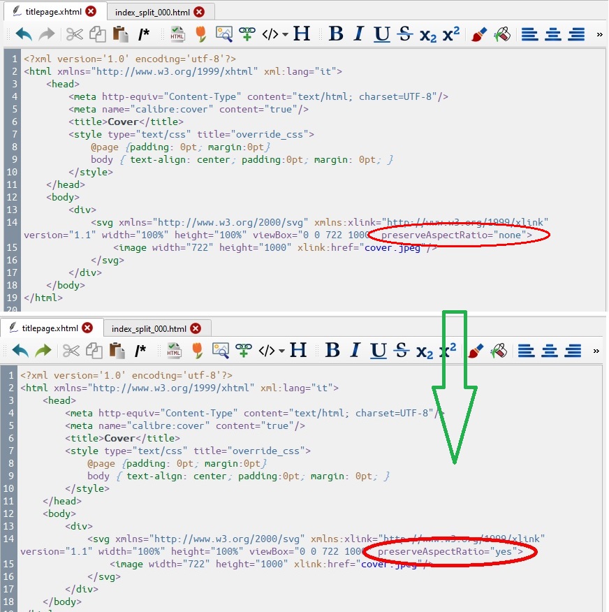

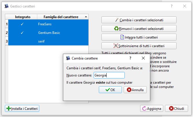

Hello,
Since I have to develop a library of over 33 thousand books, in order to facilitate my work and, I imagine, also that of many others, can I ask that the following changes be made to Caliber and that they act on all the selected books?
- when editing the metadata, insert a row to clear the Ids fields.
- activate a function that changes the "preserveAspectRatio" fields from "none" to "yes".
- the possibility of removing all the integrated fonts and changing them to another font.
Thank you very much.
Best regards,
Gianni

Your 3rd image will result in a invalid argument. (It is not a True/False)
 preserveAspectRatio="xMidYMid meet"
There are already Bulk tools for replacing covers using the current proportions rules.

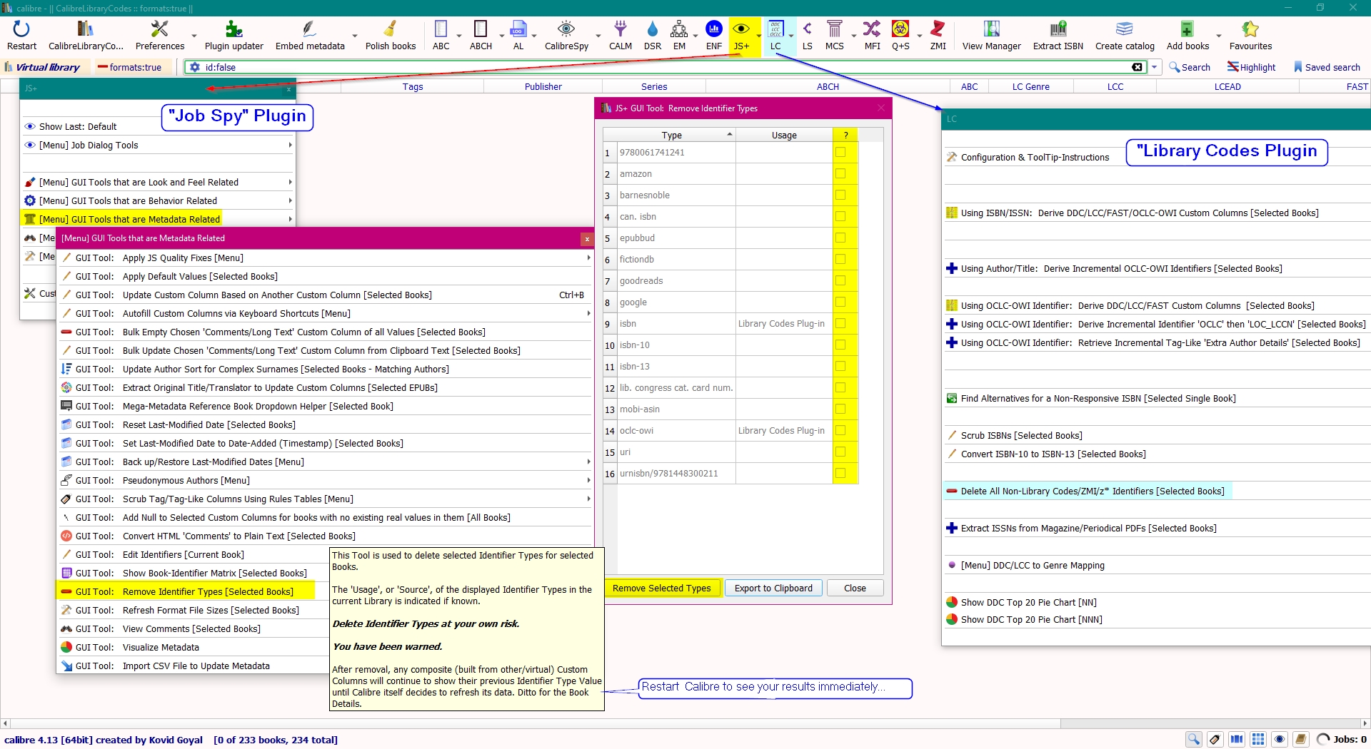

Plugins for Identifier metadata issues
There are two (2) different Plugins to help you with Identifier metadata issues in different ways.
See the attached.
DaltonST

DaltonST, thank you for your trick, it work very well...
gianni_1 is offline   Reply With Quote

Originally Posted by gianni_1 View Post
theducks I'm sorry for my ignorance about this wonderful program and thank you very much for your trick, only one question: where I can put this code?
My error: The second image. you already circled it in red.
the bottom value was just wrong (yes is not valid), it is not a True false value.
use the value I showed to keep aspect and center (there are other values if you look up more about SVG. The don't do what you wanted. The original 'none' just said: 'do nothing (else) to the image'.

hi theducks,
thanks, perfect, now i understand what is the value to use. My question is: if I select "n" books, is it possible to change the value of their preserveAspectRatio fields to "xMidYMid meet" at all at once?
Thanks again and bye,
Gianni
hi theducks,
Your screenshot in the first post is for the cover. If that is what you want to fix, then you should be able to use Polish books for that, or the Modify ePub plugin. These use the default conversion settings. You can set these through the Preferences. Go to the Output options and then select epub. Select the "Preserve cover aspect ratio" option and make sure the "No SVG cover" option is not selected.
