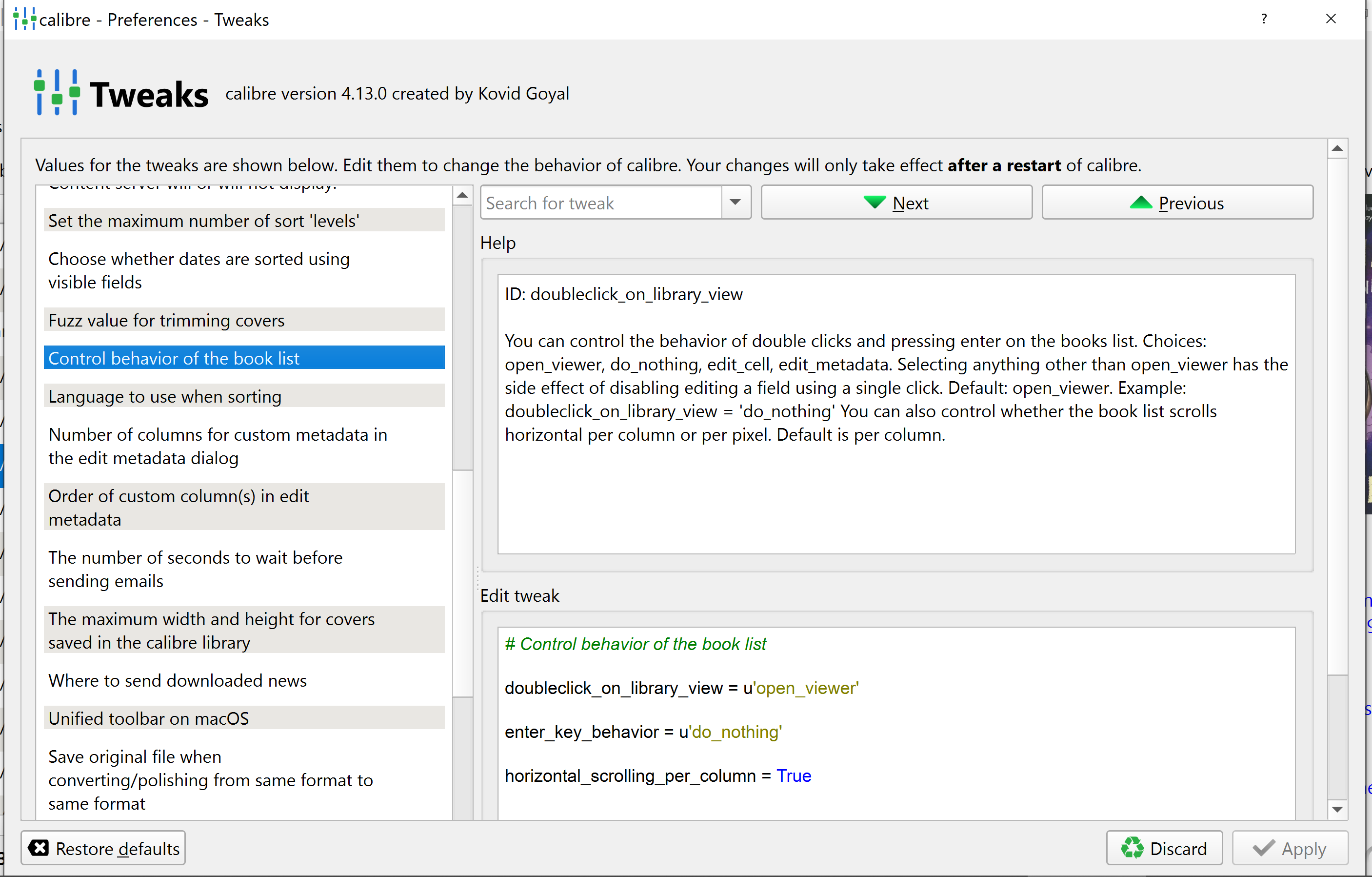

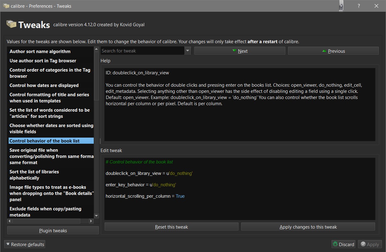

@jguneysu - could you post screen shots of a) the relevant custom column definitions in the different libraries, b) the Control behaviour of the book list tweak (yes it does operate on all libraries)

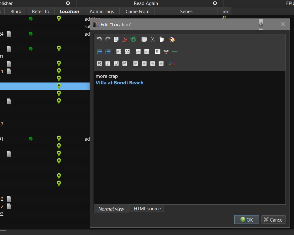

And, what happens if you Press F2 on the book list cells HTML long text columns should show this, Plain long text columns should show this, BR |
