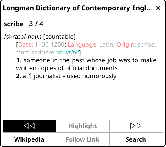

Okay, those work. But it has weird formatting and a bunch of jumble. Some looks like code even.
For example when using the 'Oxford's Learners dictionary' the word "Scribe" for that word it comes up with this:
[ scribe scribes scribed scribing ] BrE [skraib]
z_scribe__gb_1.wav NAmE [skrib]
z_scribe__us_1.wav noun a person who made copies of written documents before printing was invented
World Origin:
Middle English (originally referring to a Jewish record-keeper): from Latin scriba , from scribere
'Write'
Example Bank:
• Before paper was common, medieval scribes used parchment or vellum.
And this was one of the clearer ones. But at least you can get the definition out of it.
Using the 'Oxford English Dictionary 2nd Ed' is much worse with the jumble and code.
Thanks anyway

@Mora That looks like an old one version, where the wav-files references aren't stripped. I'll update those links, tomorrow. The present version of Oxford 2nd Ed. looks rather better than Advanced Learners 8th, though.
However, aside from that, what your are looking at is British-English [pronunciation],
North-American-English [pronunciation].
Could it be that you're seeing raw html-code in your pocketbook? I can't take a look myself: Returned the PocketbookInkpad3Pro, because it was too laggy.
Attached screenshots are from Koreader on my Linux desktop.

The newly converted dictionaries are uploaded here and the links are updated.

@Mora I ran into the same problem you had: html-tags appearing in the result.
Apparently, the script was a bit enthusiastic in converting '<' symbols to '&lt;'. I should have asked for a link to the dictionary that generated the issue. The code in github is now updated to handle it.
