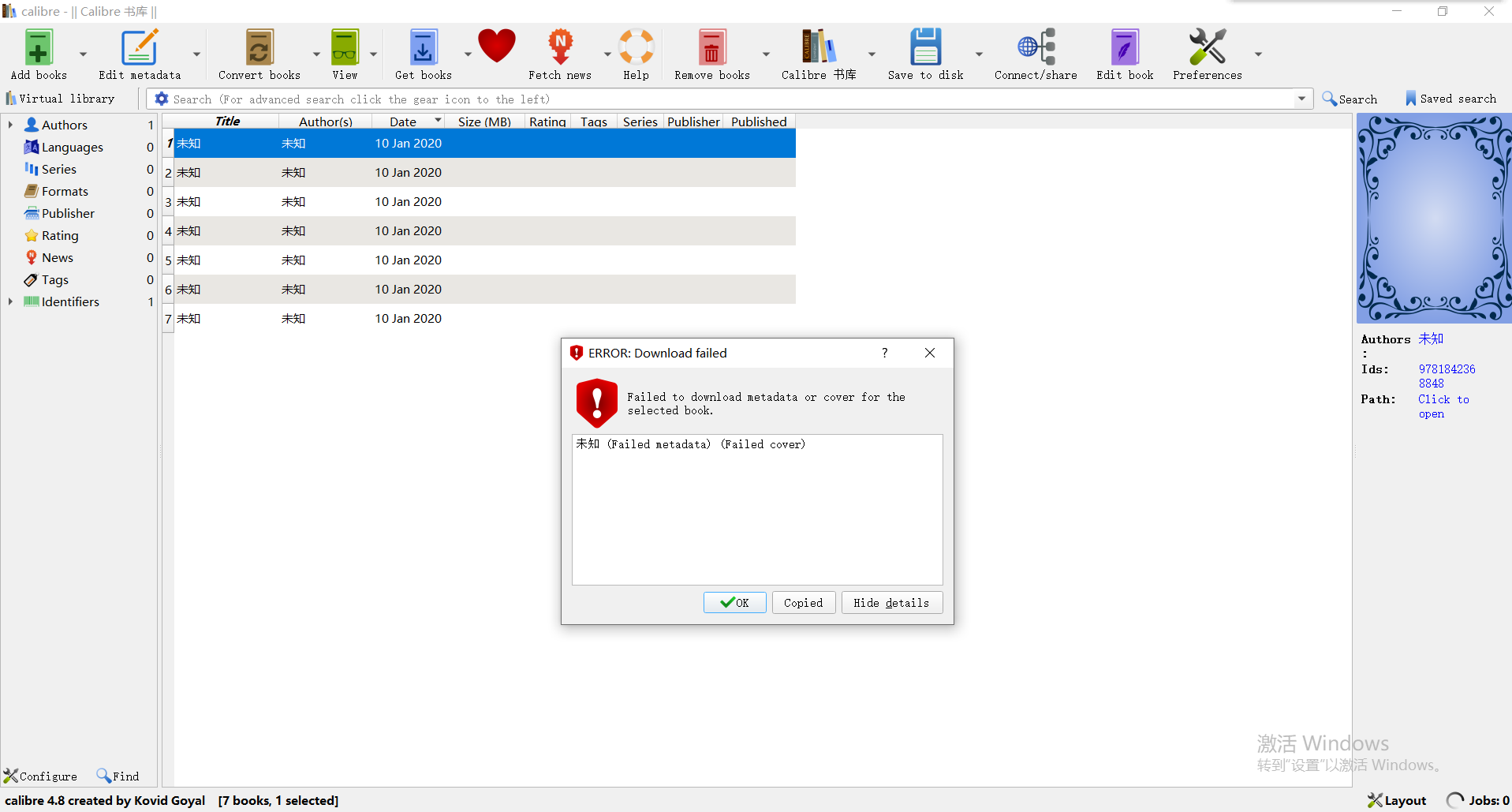

calibre, version 4.8.0
ERROR: Download failed: Failed to download metadata or cover for the selected book.
未知 (Failed metadata) (Failed cover)

Old 01-10-2020, 08:14 PM   #14
Celialiu
Celialiu began at the beginning.
Posts: 9
Join Date: Jan 2020
My bad, some of those have English ISBN's
But the title is not ASCII (and to my untrained eye, the same. which can not be for a lookup) So, I think you created a 'perfect storm' by translating the title but using English ISBN
all those books are english books and have english isbns
Celialiu is offline   Reply With Quote
