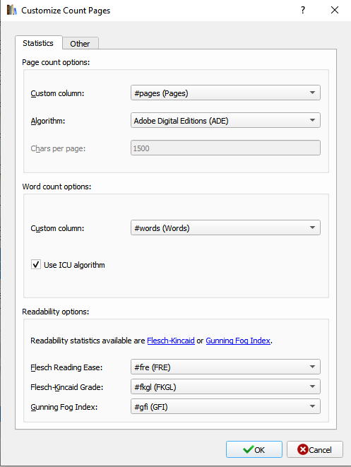

Could you post the log from a count? It doesn't matter which, I just want to check in case it shows anything strange.
Nothing hugely useful at a glance:
Count Page/Word Statistics
do_count_statistics - book_path=C:\Users\simon\AppData\Local\Temp\calibre_6yaerj\9cqwln_count_pages\5433.epub, pages_algorithm=2, page_count_mode=Estimate, statistics_to_run=[u'PageCount', u'GunningFog', u'WordCount', u'FleschGrade', u'FleschReading'], custom_chars_per_page=1500, icu_wordcount=True
do_count_statistics - job started for file book_path=C:\Users\simon\AppData\Local\Temp\calibre_6yaerj\9cqwln_count_pages\5433.epub
Logfile for book ID 5433 (Complete Works)
	Method of counting _page_count_mode=Estimate _download_sources=[]
	results= {u'GunningFog': 10.694577889041557, u'WordCount': 1155998, u'FleschGrade': 6.591641012852087, u'FleschReading': 79.86374324684013, u'PageCount': 2504.0}
	Found 2504 pages
	Computed 10.7 Gunning Fog Index
	Found 1155998 words
	Computed 6.6 Flesch-Kincaid Grade
	Computed 79.9 Flesch Reading
5433
do_statistics_for_book:  C:\Users\simon\AppData\Local\Temp\calibre_6yaerj\9cqwln_count_pages\5433.epub 2 Estimate [] [u'PageCount', u'GunningFog', u'WordCount', u'FleschGrade', u'FleschReading'] 1500 True
	Page count: 2504.0
	Word count using icu_wordcount - trying to count_words
	Word count - used count_words: 1155998
	Word count: 1155998
	Results of NLTK text analysis:
	  Number of characters: 5468651
	  Number of words: 1251081
	  Number of sentences: 68486
	  Number of syllables: 1607495
	  Number of complex words: 109300
	  Average words per sentence: 18
For this book, using language=eng
	Flesch Reading Ease: 79.8637432468
	Flesch Kincade Grade: 6.59164101285
	Gunning Fog: 10.694577889
It was faster this time - 26m06s today vs 26m36s yesterday
I'm using the current Calibre Windows 64-bit build. I update everytime Calibre reminds me there's a new version.
Are there any Calibre debug options that might give a more verbose log file?
EDIT: I'm using the ADE page count algorithm if that's relevant.
EDIT2: Attached screenshot of my Count Pages configuration
snarkophilus is offline   Reply With Quote
It does tell me what I wanted to know. The count is done in a couple of ways. I wanted to check it was happening correctly. The two lines I highlighted tell me it is.
And the configuration is what I was expecting.
The problem seem to be in a library calibre has. The only other place I can see that it is used is in the editor for the spelling check. Can you open the book and then open one of the internal files? If the option to show mispelt words is on, it will probably take a long time. It is different to the plugin. The spelling check is done at the tag level (basically per paragraph) whereas the plugin does it for the full book in one go.
Do you mean open the book with Calibre's in built epub editor? I've got the "Show misspelled words underlined in the code view" option enabled (must be the default, I only use Sigil and haven't used the Calibre editor). DorianGray.htm is the biggest text file in the book and it opens pretty much instantly.
Old 12-07-2019, 09:34 PM   #1319
NiLuJe
BLAM!
NiLuJe's Avatar
Posts: 13,507
Karma: 26047224
Location: Paris, France
@davidfor:
Duh. That is indeed currently burning a hole in a CPU core ;p.
EDIT: Nothing untoward happening in the editor, and spellchecking works as expected.
Old 12-07-2019, 10:07 PM   #1320
davidfor
Posts: 24,905
Karma: 47303826
Location: Sydney, Australia
My statement was badly phrased. It's about how long it takes to do the spelling check and mark the words. I'd expect this to take a long time for a decent size for you. What you could try is to turn off the spelling option, reopen the file and go to the bottom. Add a misspelled word and turn the option on again. For me, the word gets marked in a few seconds. If what I think is going on, it might take minutes for that to happen.
count, count pages, page count, pages, plugin
