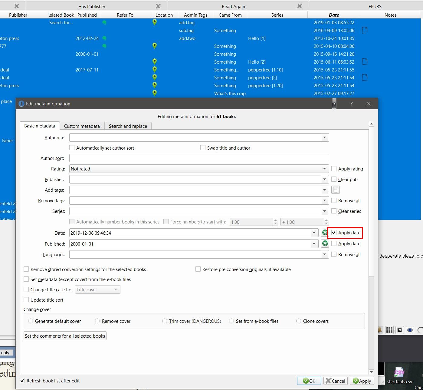

Originally Posted by gandoe View Post
BetterRed - thanks for the tip. I have not systematically used the Date for some other purpose, nor do I believe I performed any global search and replace for that field. While I might have inadvertently changed one or two records, this problem occurs across most of the records I could check easily (comparing Amazon digital purchase date).
Are the incorrect dates randomly distributed, if many books have the same incorrect Date (sort on Date to eyeball check), that would suggest something might have happened in Bulk metadata edit - such as
Before Apply or OK (the value in Date is from the last book in the selected list)
Name:	Before Apply.jpg

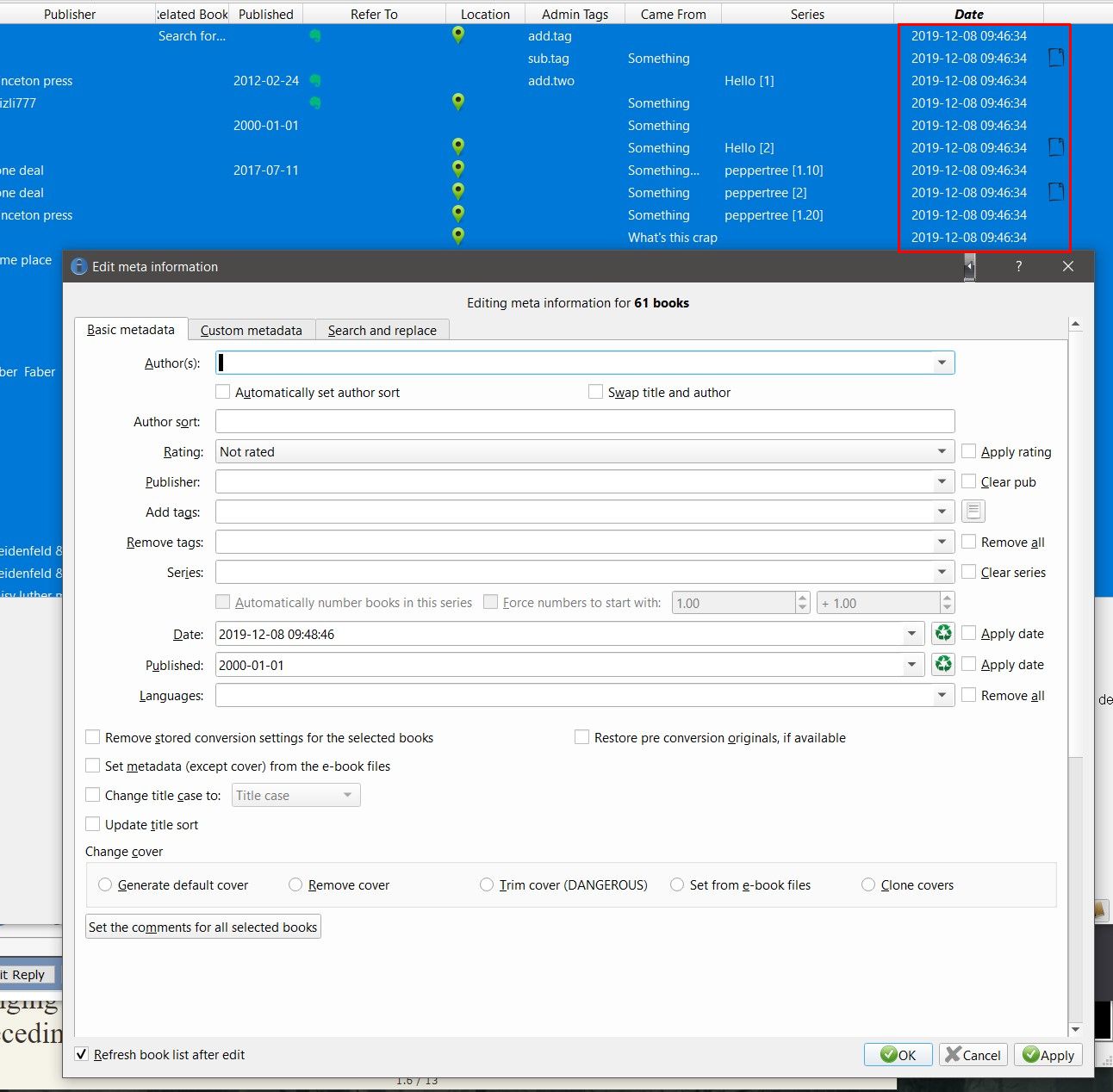

After Apply or OK
Name:	After Apply.jpg
Whooska - all Dates set the same
