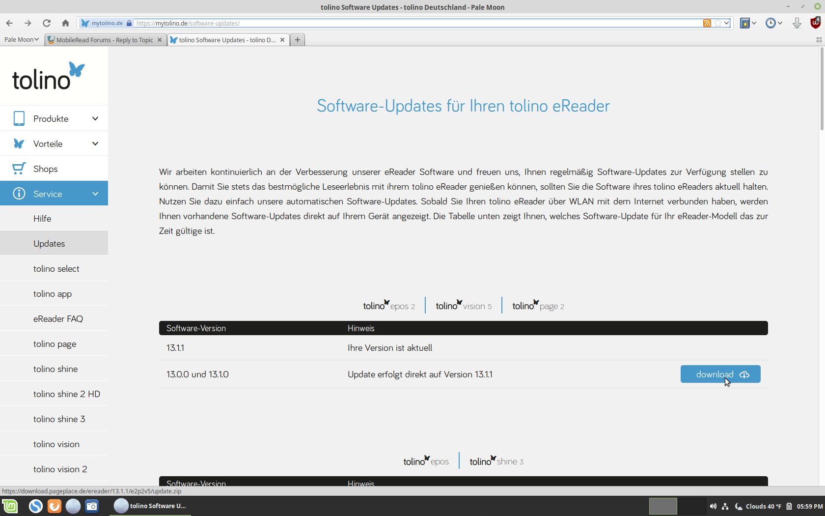

What's really odd is that the English website only has 13.1.0 available and, if you hover over the link, it shows a beta download. The German website, on the other hand, goes to a completely different download directory. I don't have a problem using the German site (because I've done it in the past) but it's weird that they don't get the English site updated.
ID:	175110   Click image for larger version
ID:	175111   Click image for larger version
ID:	175112   Click image for larger version
The difference between 13.1.0 and 13.1.1 is in handling of CARE DRM for Onleihe books
