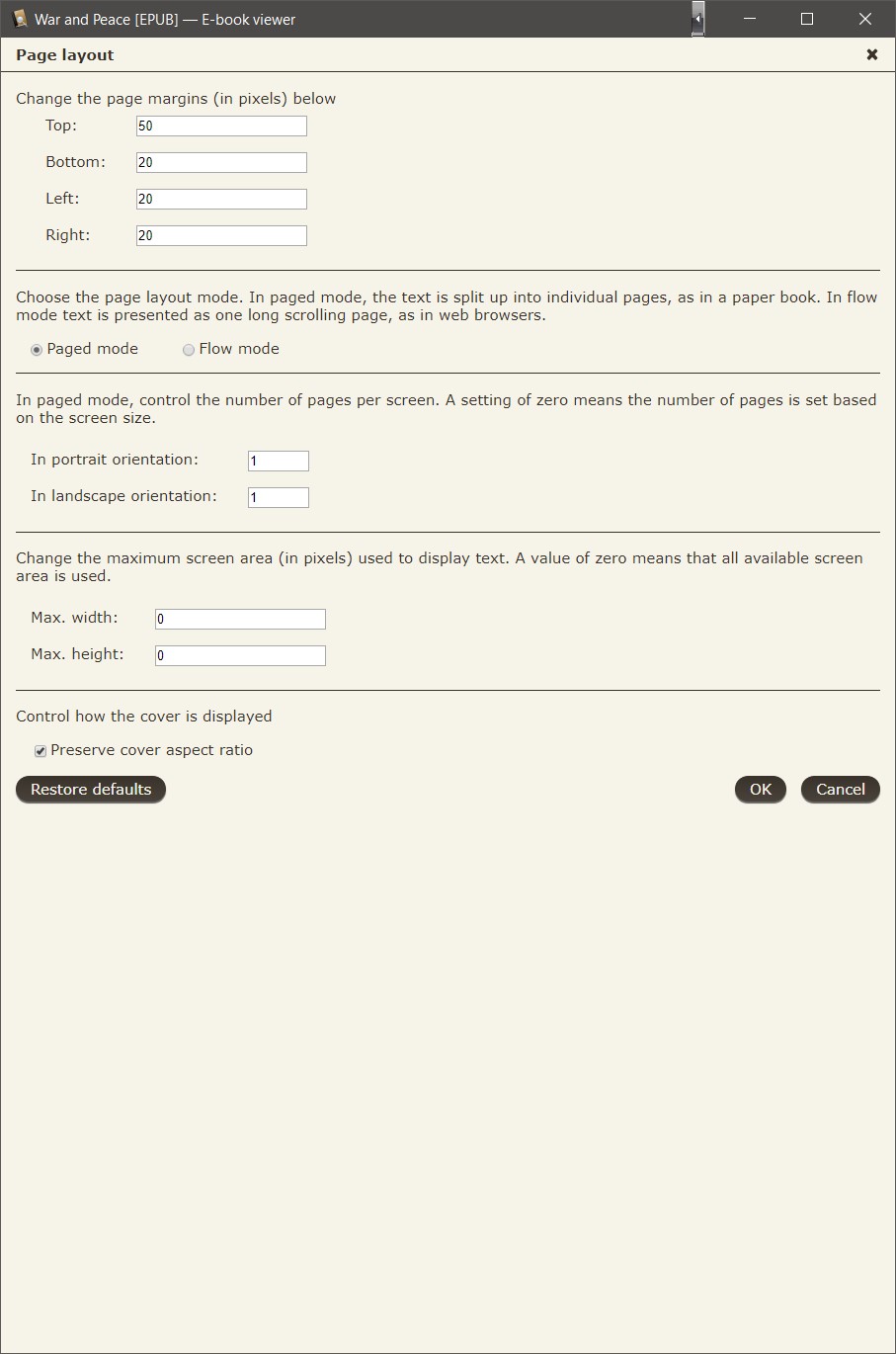

If I have these settings - I think these are the relevant ones:
Name:	Annotation 2019-10-19 065431.jpg

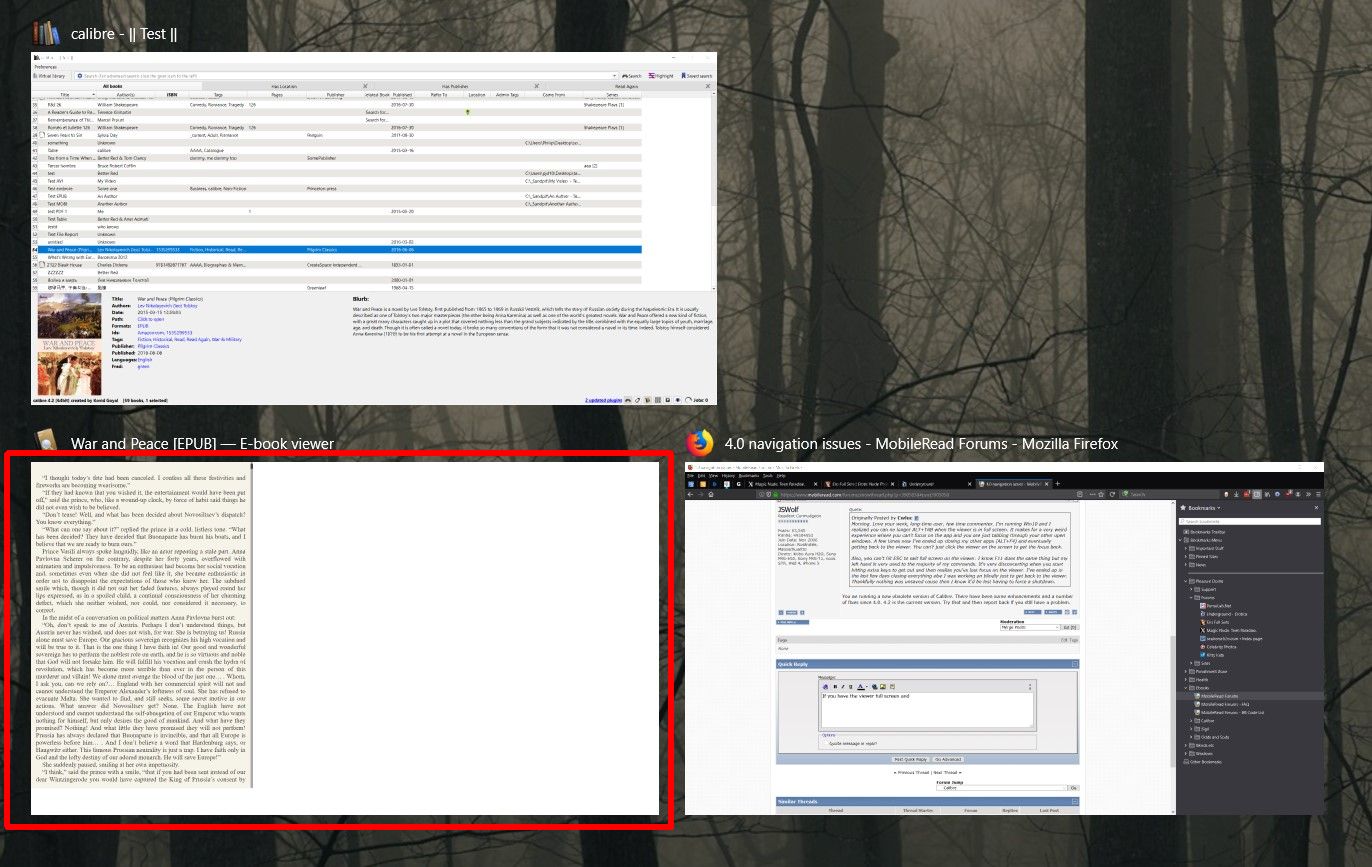

If I press F11 to get into full screen, and then Winkey+Tab, I get this:
Name:	Annotation 2019-10-19 070018.jpg

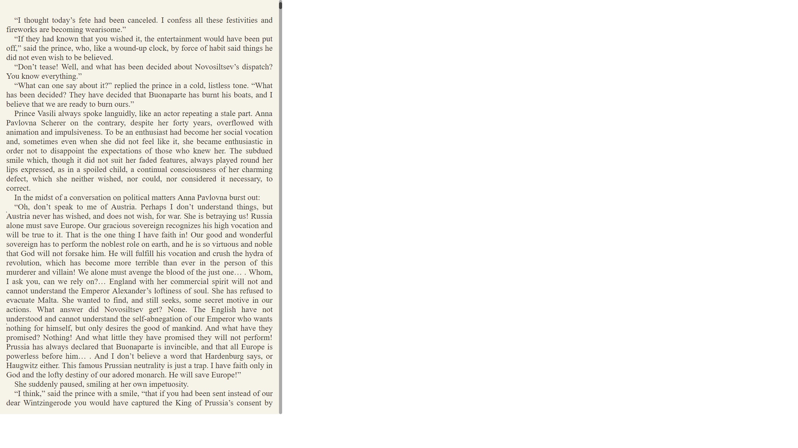

If I press F11 to get into full screen, and then PrntScrn (which fires up Snip and Sketch), I get this
Name:	Annotation 2019-10-19 070504.jpg
If I press any global key used by Windows, the text goes from full screen width, to the width of the viewer when its not full screen as can been seen above. the way out of the 'mess' is to hit F11, twice.
I can't get a Snip and Sketch screen shot with Alt+Tab pressed, but you should be able to work out what happens.

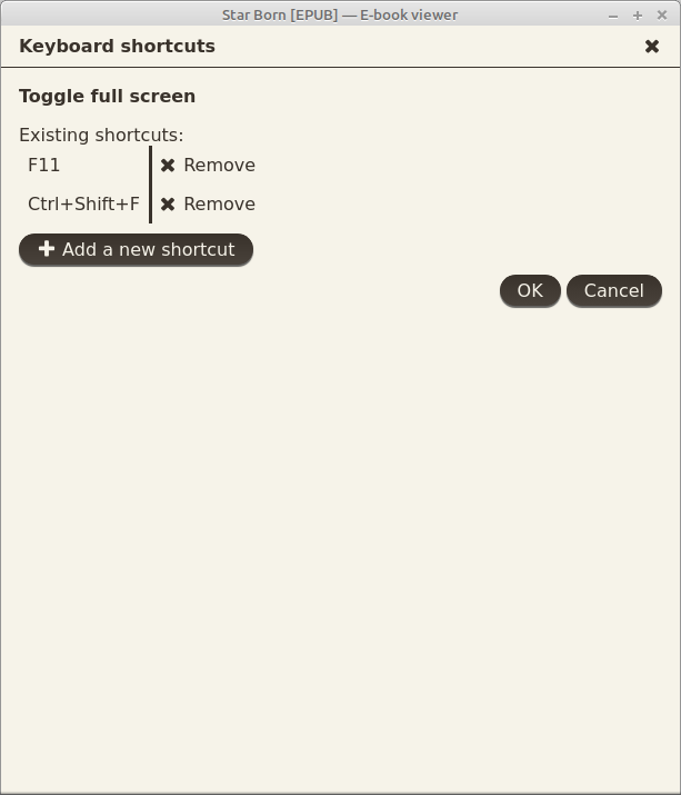

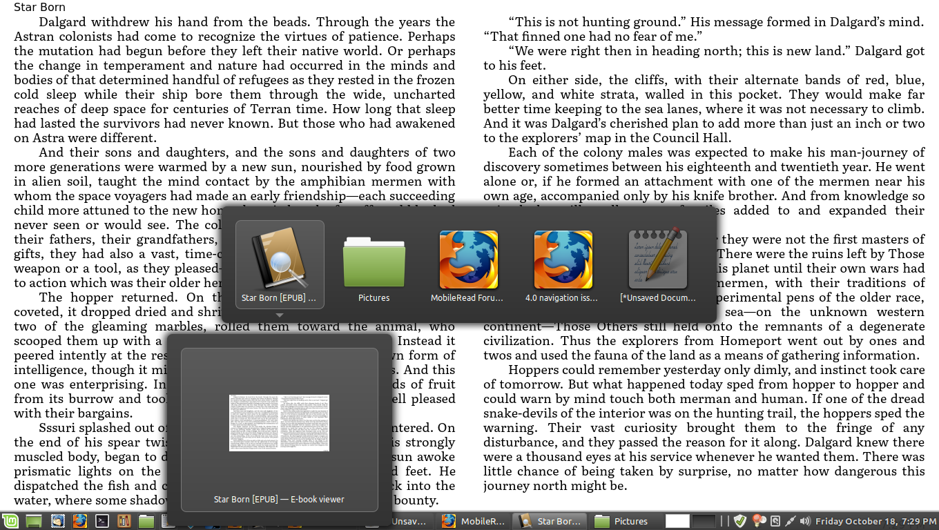

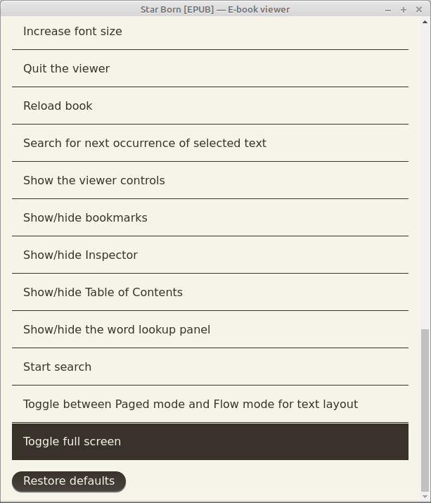

F11 and Ctrl-Shift-F works for me.
Alt-Tab brings up this:
Name:	Screenshot from 2019-10-18 19-29-06.png
Linux Mint 19.2
bernie
Name:	Screenshot from 2019-10-18 19-19-28.png
ID:	174354   Click image for larger version
Name:	Screenshot from 2019-10-18 19-20-17.png

@BR: Since you have explicitly changed the preference in Page mode to show only a single column, it is not surprising you are getting only a single column. Set ti back to zero and you will get multiple columns.
