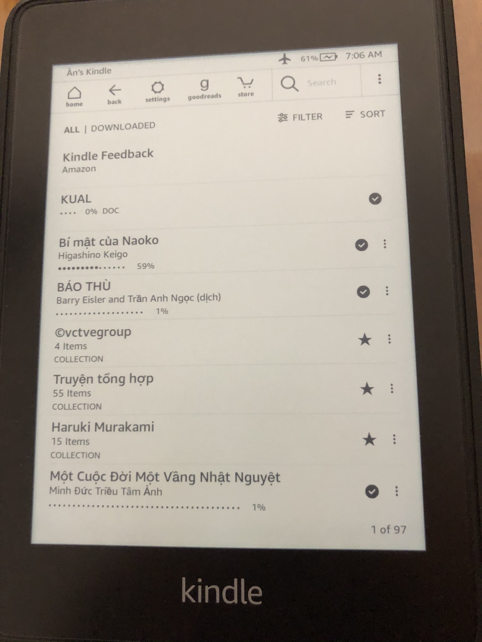

Feedback on PPW4 jailbrocken and on 5.12.1
Delete the folder named "update.bin.tmp" (*******Must be*****).
Install lastes HOTFIX update from https://www.mobileread.com/forums/sh...d.php?t=225030
Reboot and make sure this file on your screen. (Kindle Feedback)
It's safe to manual update your device to 5.12.2

Loaded latest hotifx on to my KOA2 and do NOT have "Kindle Feedback" as a new book or document. Do I need to remove the tmp folder before hotfix install?

@hius07: That's to be expected, the bridge only creates the flag on FW 5.12.x to avoid the wide-ranging side-effects it has .
Are you saying I would only get the "Kindle Feedback" entry if I installed one of the 5.12.x updates?

@radamo: Yes (I forgot to CC you in the answer you quoted ).
One more question since I would hate to lose my JB. :-D
Is it now recommended to remove the update.bin.tmp.partial directory before manually updating?

No idea, but, it's probably doing more harm than good on 5.12 anyway.
