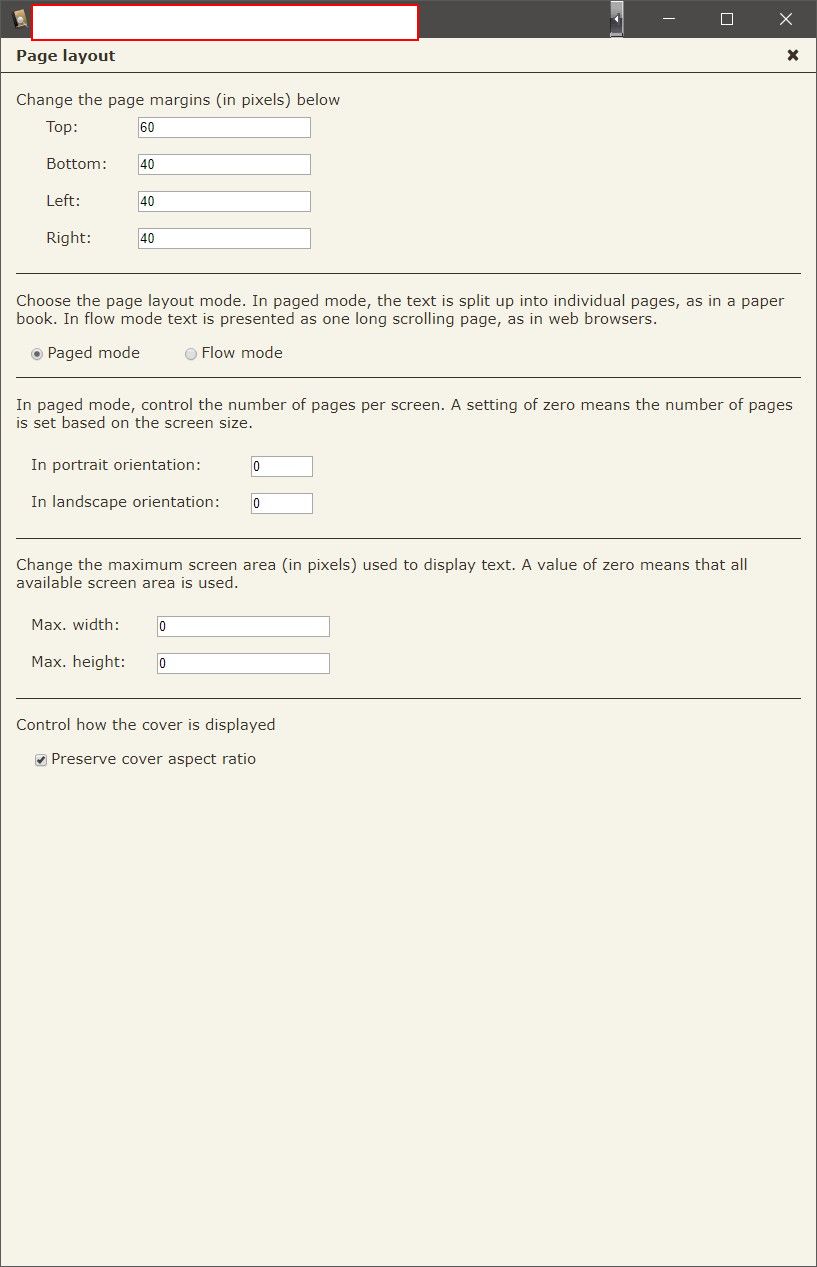

I figured out how to stop the search bar hiding text and how to make the Percent Read not come and go - set top and bottom margins to non zero. The default settings for the margins in the beta is zero, maybe they should be changed to ??.
If I search for something and its not found I get an intrusive pop up message that can only be dismissed by using a mouse left click on its black X - after which I can't move the text with the keyboard until I move it with the mouse scroll wheel Ψ³
The default settings are definitely not zero
kovidgoyal is online now
This is from a portable 3.99.8 installed a few minutes ago
Name:	Annotation 2019-09-29 204806.jpg
This is from a portable 3.99.8 installed on Friday (late) that I altered this afternoon
Name:	Annotation 2019-09-29 205500.jpg
The loss of keyboard interactivity also happens if I pop the search box and hit escape
BTW Ctrl/t and Ctrl/f are not working for me and I can't see that anything else is using them - I changed Ctrl-T to Ctrl+Alt+T and its fine, I'll have to change the other one - interestingly Ctrl+F works in Firefox, my file manager, and Chrome happily enough.

@BR: The default top/bottom margins are 20 however there was a bug in the viewer settings migration code where if there were no previous viewer settings, the top and bottom margins were being set to zero. Now fixed.
Eh - when I installed version 3.99. 32bit I was disappointed that none of my existing viewer settings (e.g. colors) were 'migrated' - I sighed, shrugged, and moved on. If they should have been migrated, then one reason I can think of why they might not have been, is that my configuration is not in the default location; it is in the location referenced by CALIBRE_CONFIG_DIRECTORY.
You might recall I had a loss of window size issue when switching between 3.47 and 3.99 - see post #18. Given the fact that my settings were not migrated, and I had the Qt induced window size problem, I uninstalled the 32bit version and installed a fresh portable.
But all that's largely irrelevant, but the loss of keyboard functionality after using search is very relevant. It's just the Search Tool that does that - and maybe the Error popup. Using the ToC or Lookup tools does not lead to loss of keyboard functionality.

@BR: IIRC color schemes are not migrated, since they are too different in how they work between the two viewers. And your search box focus issue will be fixed, assuming I can replicate it, when I have the time.
Fixed and you can use Esc to dismiss the no match found popup as well.
That is a windows specific bug in webengine. Apparently ctrl+letter results in the key event having an ascii control code as they key, sigh. Can work around it I suppose.
No need to fix on my account, I've already changed it to Ctrl+Alt+F, now I can stop worrying about it
