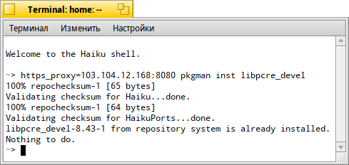

As for needing to shoehorn a different version of pcre into Sigil's third-party source folder, you probably didn't need to do that. You probably only needed to install an additional _dev (or _devel) package for pcre from your package manager to be able use the system version. The missing libpcre16 would have been provided by the dev package for pcre (or pcre2|3--whatever haiku's package manager calls it).
This is already in the system. And if you substitute libpcre2-16, that fails.
Yes. That's because there is no libpcre-16 package. The libpcre16 shared library is typically provided by the libpcre (or libpcre-dev[el]) package on most systems. If it's not on yours, then pcre was specifically built to leave out support for libpcre16. This is not something most systems do.
But regardless... as I previously mentioned, I believe you've already successfully built Sigil on your system. It's now just a matter of making sure the two required python modules are installed and that Sigil is being launched with the correct environment.

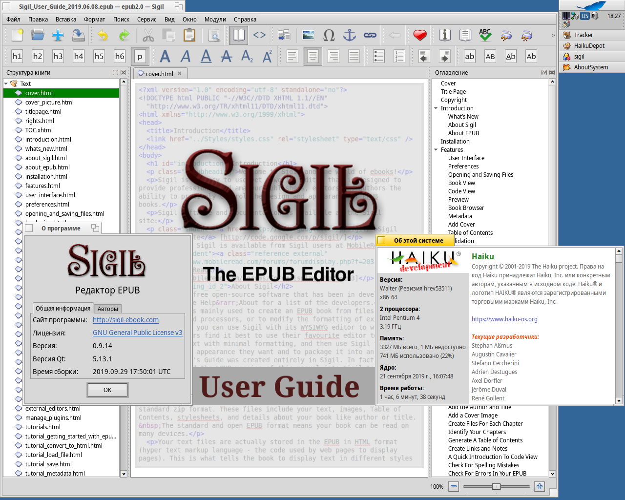

Hurrah! Hurrah! Hurrah!
This is just some kind of miracle. Glory to DiapDealer!!!
Today is truly a momentous day. Remember all of it.
Hardware: Intel Pentium 4 3.2 GHz, Socket 478
Operating system: Haiku x86_64
Software: Sigil 0.9.14
All system libraries are used (on the advice of eschwartz rebuilt pcre).
-- Found ZLIB: /boot/system/develop/lib/libz.so (found version "1.2.11")
-- Found PkgConfig: /bin/pkg-config (found version "0.29.2")
-- Found MiniZip: /boot/system/develop/lib/libminizip.so
-- Checking for module 'hunspell'
--   Found hunspell, version 1.7.0
-- Checking for module 'libpcre16'
--   Found libpcre16, version 8.43
-- Found PythonInterp: /bin/python3.6 (found suitable version "3.6.8", minimum required is "3.6.8")
-- Found PythonLibs: /boot/system/develop/lib/libpython3.6m.so (found suitable version "3.6.8", minimum required is "3.6.8")
-- Using System ZLIB
-- Using System MiniZip
-- Using System Hunspell
-- Using System PCRE
Many thanks to everyone who took part in this serious matter.
And finally, the hero of the occasion:
User_Z is offline   Reply With Quote
