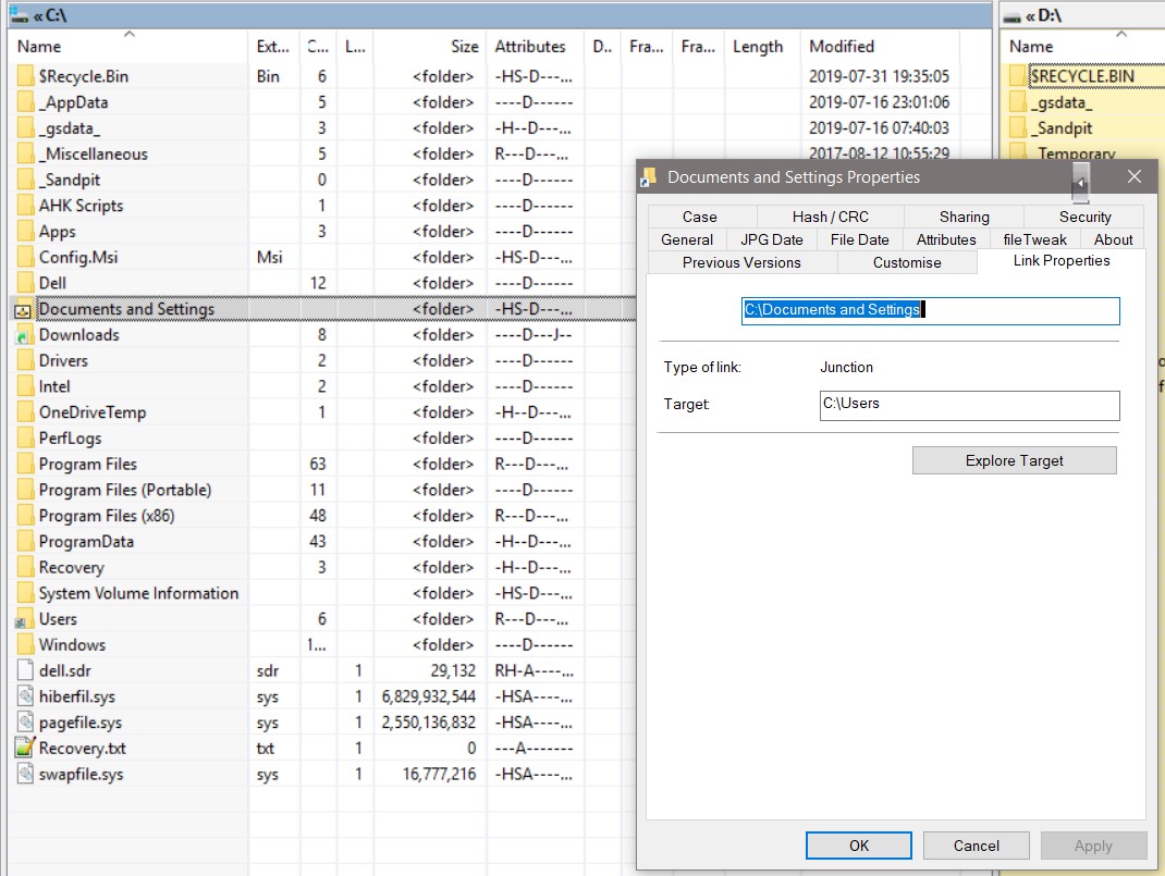

Back then it was called Documents and Settings, it's ghost lingers on, but via a hidden+system junction to Users.
Name:	Annotation 2019-08-14 081758.jpg
But, the OP can find the config folder using the time honoured method of pressing the Preferences->Maintenance->Open calibre configuration directory button - even on version 1.48.
