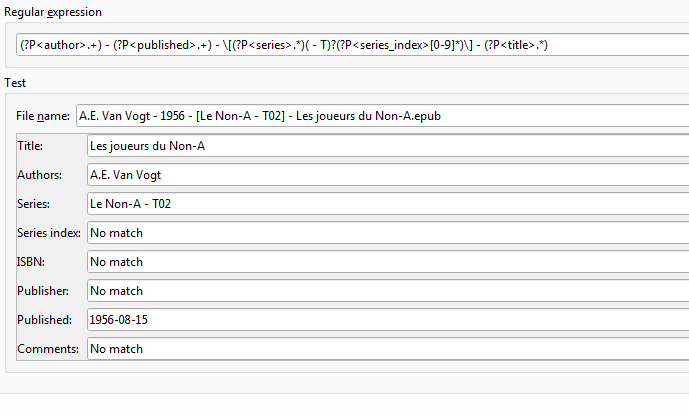

We are getting closer, but not there yet: the series index is not parsed properly
Also, I'm wondering why the year published is shown with month & day...
Screen shot attached

I could have sworn that worked. Try the following:
(?P<author>.+) - (?P<published>.+) - \[(?P<series>.*?)( - T)?(?P<series_index>[0-9]*)\] - (?P<title>.*)
And "Published" is the publishing date, not just the year. If you set just the year, it will use the current day and month.
Super mega thanks!
This is exactly what I wanted
