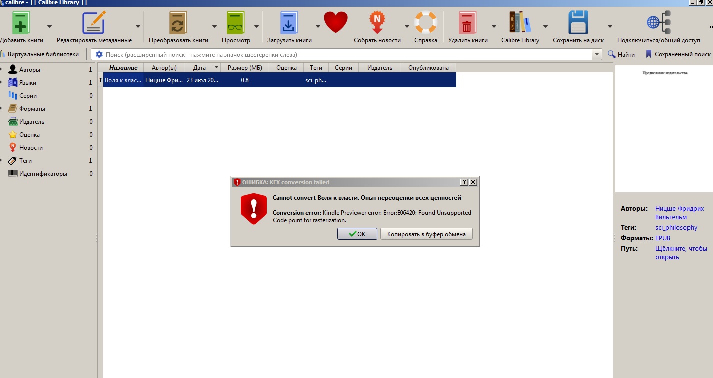

There was such a problem with the conversion epub to kfx with the error: E06420
How can this be solved?
Thanks.
I don't speak Russian so I don't know what book you have posted, but if it is under copyright then please remove the attachment from your post. Copyrighted material is not allowed on MobileRead. (Edit: Already taken care of by pdurrant.)
KFX conversion can fail for many reasons. In this case the error message appears to point to an invalid character in the text, but is not informative as to where in the book the problem lies.
In order to fix it you will have to use an EPUB editor (such as calibre's Edit Book function) to selectively remove parts of the book until it converts successfully. By trial and error you can narrow down and remove whatever is causing conversion to fail. It will likely be a time consuming process.
